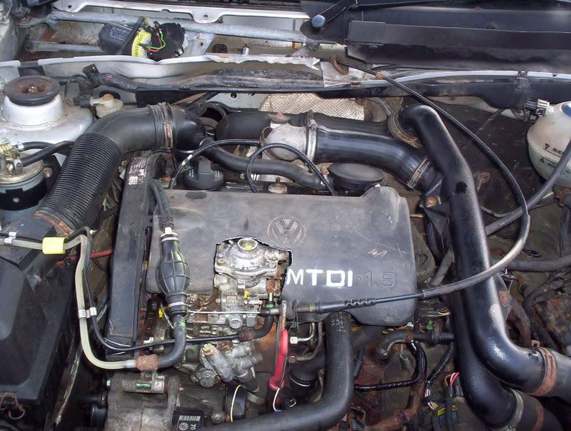

my mates 1.9D 1X Non Turbo went bang last week so he needed a new engine and quick install
so he went for a 1.9TDI AFN (110BHP) Passat Engine didn't come with ECU OR LOOM so he is going M-TDI with the Landrover Bosch 300tdi Injection pump
AFN Engine code c/w Garrett GT15 Turbo
we've had it running on the old 1X Injection pump just to test the engine which ran it but the old pump was 200k miles old and leaking all over .
Landrover 300tdi M-TDI Injection pump
injection pump bracket had to be opened up to 68mm to take the new pump

#19 ·
Yay, someone else who is walking the M-TDI line. I did out of necessity.
I have a AFN, with a slightly tweaked ABL pump. Using the AFN injectors and inlet manifold with the ABL turbo. I finally have it running but haven't taken it out yet as it needs a few bits for the MOT.
First time running the pump leaked like Niagara falls, however, my very friendly diesel specialist did his magic and replaced the main shaft seals. Turns outwoutwhen they dry out, they tend to leak. I was a bit worried that the pump just wasn't going to hack it.
I just swapped the pump bracket over and cut the rear upper cambelt cover to fit.

#33 ·
The old 1.9D pump struggles to generate the pressures required to open the TDI injectors and you have to advance the pump a lot to get it to even run. You can pump a TDI pump head on it but there's no point as it still has as smaller shaft.
The land rover pump is still a bosch Ve, but has the correct head and bigger shaft.
The whole point of it is that it's all mechanical, no ecu or wiring. It also has a load compensator (LDA) for adding fuelling under boost.
Far less hassle and expense and all the parts are readily available used. Can be done for ÂŁ500. A decent remap costs ÂŁ300.....
#36 ·
We had to advance it a whole tooth to even get it to run.
Didn't get it set up because the pump was leaking due to the higher pressure so had to chuck it and bought the landy 300 one.
Because of the higher break pressure of the TDI injectors the start of injection has to be much earlier to give enough time for the pressure to build. But as stated above it isn't recommended as the 1.9D pump has a mcuh smaller main shaft. It's not really up to the job.
