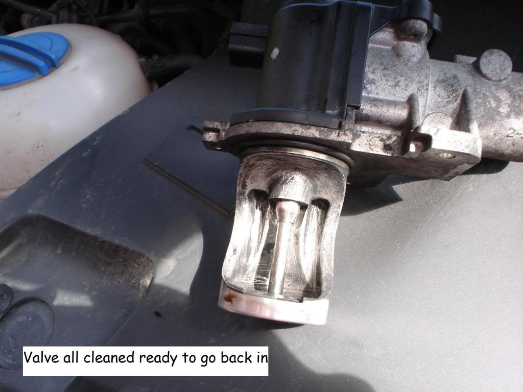

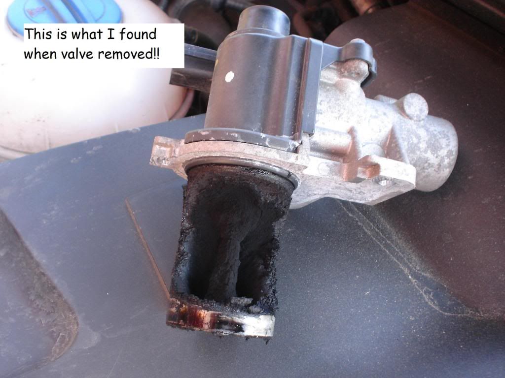

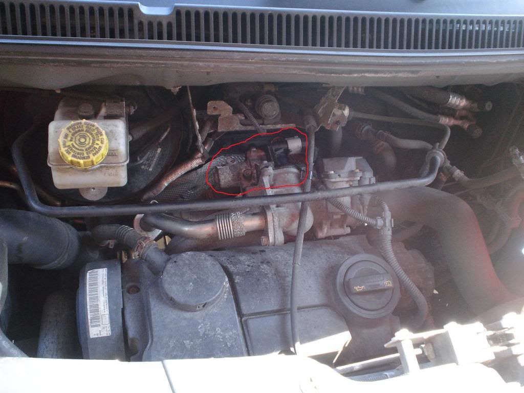

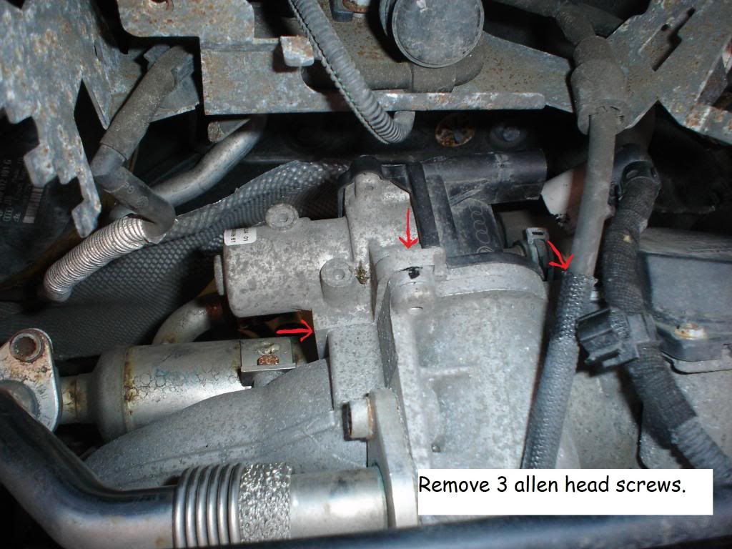

Removed my EGR valve to see if it needed cleaning heres what I found!! And a few pics to hopefully help others. 1.9 BRS engine
Re-fitting is reversing of removing and plug in electrical plug again.
Hope this helps.T:T:

Hey there, I'm in the middle of taking the EGR off my VW T5 1.9 2008.
3 allan head screws are not out and EGR is loose and wants to come out, can I get that electrical connection off!! No, is the simple answer! Do they just pull off or is there a catch you need to release before it comes off. Just dont wanna yank it and break something!
Thanks in advance guys.
#32 ·
The electrical connector is a fiddly thing to disconnect unless you've done it before!
I managed to remove the EGR from mine the other day with out disconnecting the wiring connector, with the EGR pulled out of the manifold, you can turn the EGR over and see the tab you need to flick out to remove the connector.
