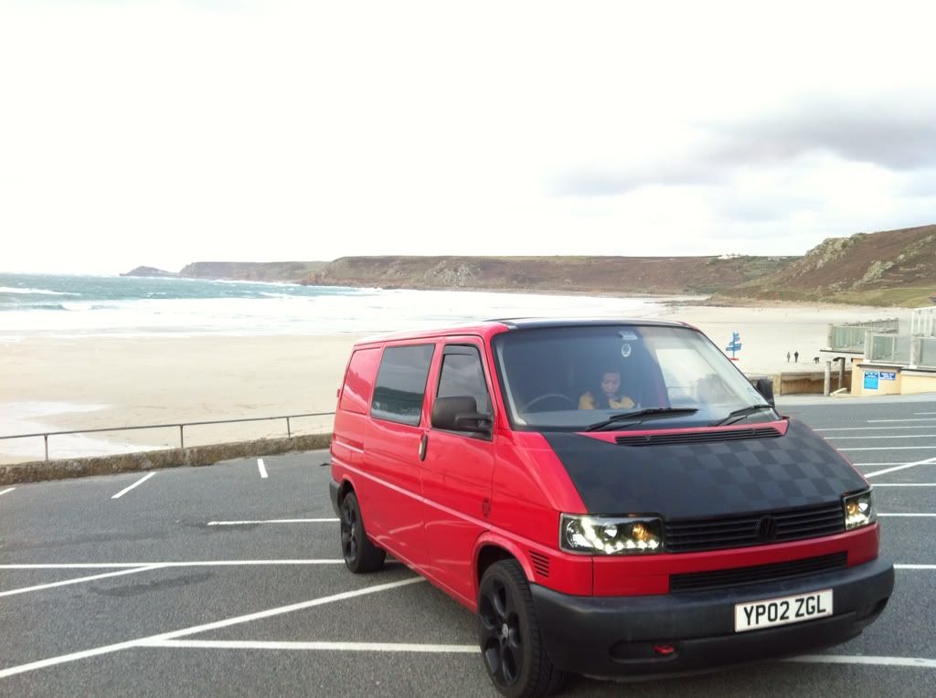

Morning all, yesterday fatherchristmas brought me these rather lovely lights as an early Christmas present, looked great in the dusk but when I took it for a drive low beam nearly killed me! It only shines about 2 metres infront the van. Does anybody have any idea on how to adjust them ? I don't have an electric motor like the odd instructions suggested, any help would be much appreciated, cheers Morgan

Dude,
I had the same short beam problem.
In the end, I got the lights aligned to MOT standards. It was a simple case of using washers to adjust and align the beam.
The amount of light given will never be that good as the VW loom is pretty poor. There are a couple of traders, Autosparks and Upspex, who sells upgrade wiring looms and better bulbs.

on the back there is a grey block with a "bolt" coming out of it, screw in the bolt this will higher the beam T:
Tis easier to unscrew the grey piece and then screw it in

Cheers for the comments, as it was on a small estate I went door knocking and managed to find out who did it, he has now accepted liability so I'm claiming against his insurance, good news is they are going to do me a good price on giving the whole van a blow over as well as sorting out the door T: As far as the lights go I tried altering them myself but got no where, took them to a garage today and they pointed out that the adjuster comes unattached to the back of the lamp holders incase you want to attach electric motors, so after some fiddeling iv managed to get them pointing the right direction now :). Cheers and happy Christmas *<:)>

cheers for the advice, i seem to think they are brighter than my old lights which didnt have the upgrade, but i will deffinatly look into it for these, the brighter the better, iv got some hid bulbs from the last, but it says not to put them in, why is this? they blinding? is upspex a trader on here?
