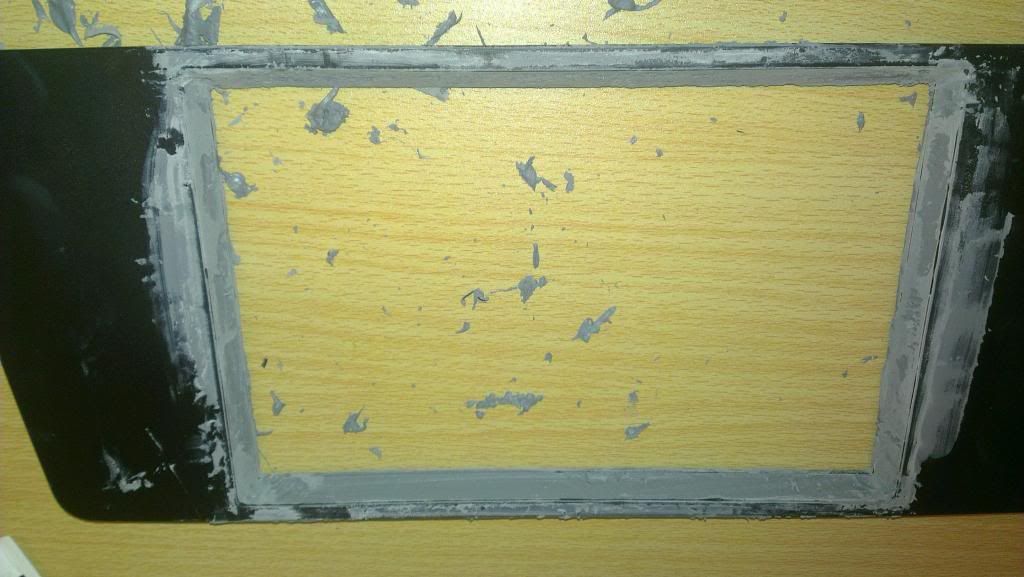

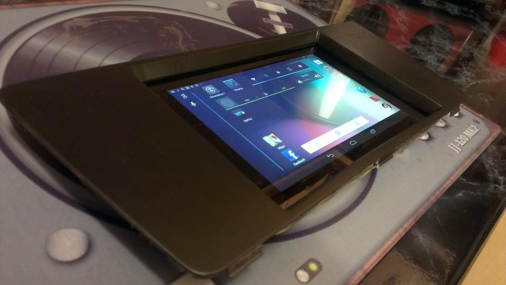

I have decided to use Plastic bumper repair putty mostly because i hate fibreglass but also as I've never used the stuff and wanted to try it
I applied this stuff to the edge to create a more frame like look. the stuff looks very messy to start with as you build it up but i found that i could start to shape it with a stanley blade before it fully dried, making the sanding work a lot easier

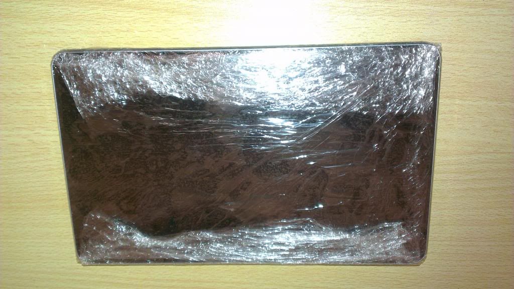

The next step was the scariest. I want the tablet to be removable so to create a snug pocket on the rear of the panel for the tablet to slide in and out of, I needed to use the tablet itself as a mould.....
So with the tablet wrapped in cling film I started to cover it in putty

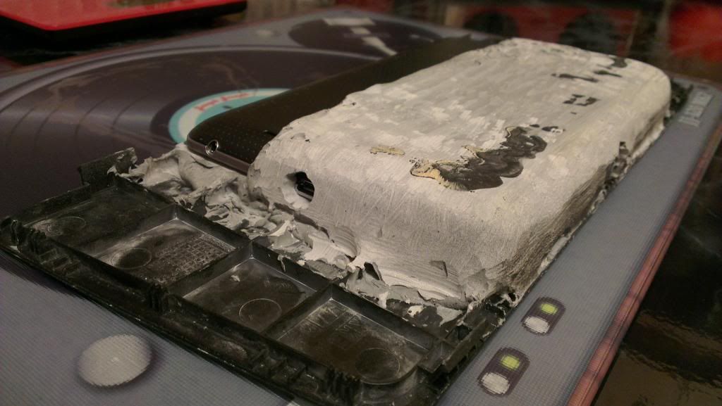

once the first layer had dried I removed the tablet and cut off the top of it to create a pocket. I then used more putty to bond the mould to the panel and continued to build up the layers.

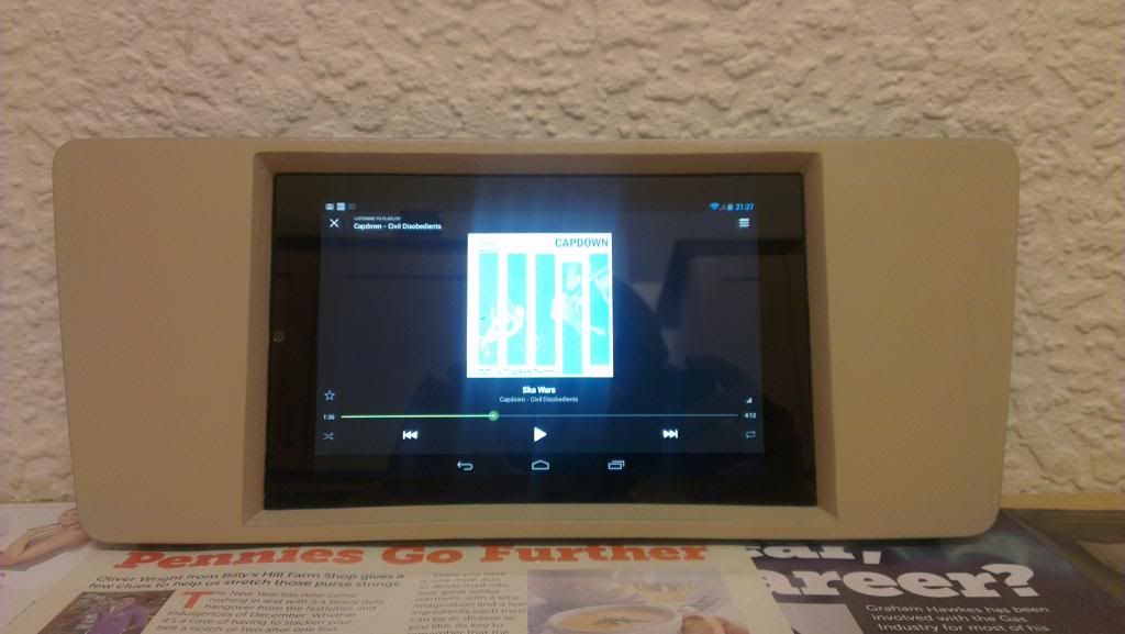

once dried, the tablet slides in to place nicely

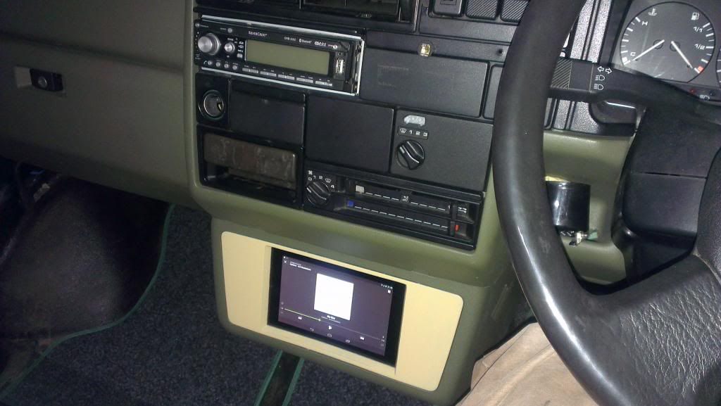

After the first sanding and shaping a gave it a quick coat of paint to help with sanding it nice and flat.
first trial fit

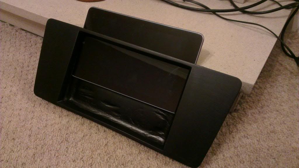

I've since done a bit more sanding and given it a coat of black bumper paint. Apart from the sanding marks and some lows in the putty that need filling, the finish looks just like the black plastic of the dash so I'm really chuffed.
The tablet slides in from the top and is a really snug fit
The back is still very messy but i will eventually build it up and sand it back to a nice smooth finish
The problem is, I've been using it in the van for a few days now to trial it. I'm finding, as i thought i might, that it's too low down to safely use for changing track or entering post codes etc.
