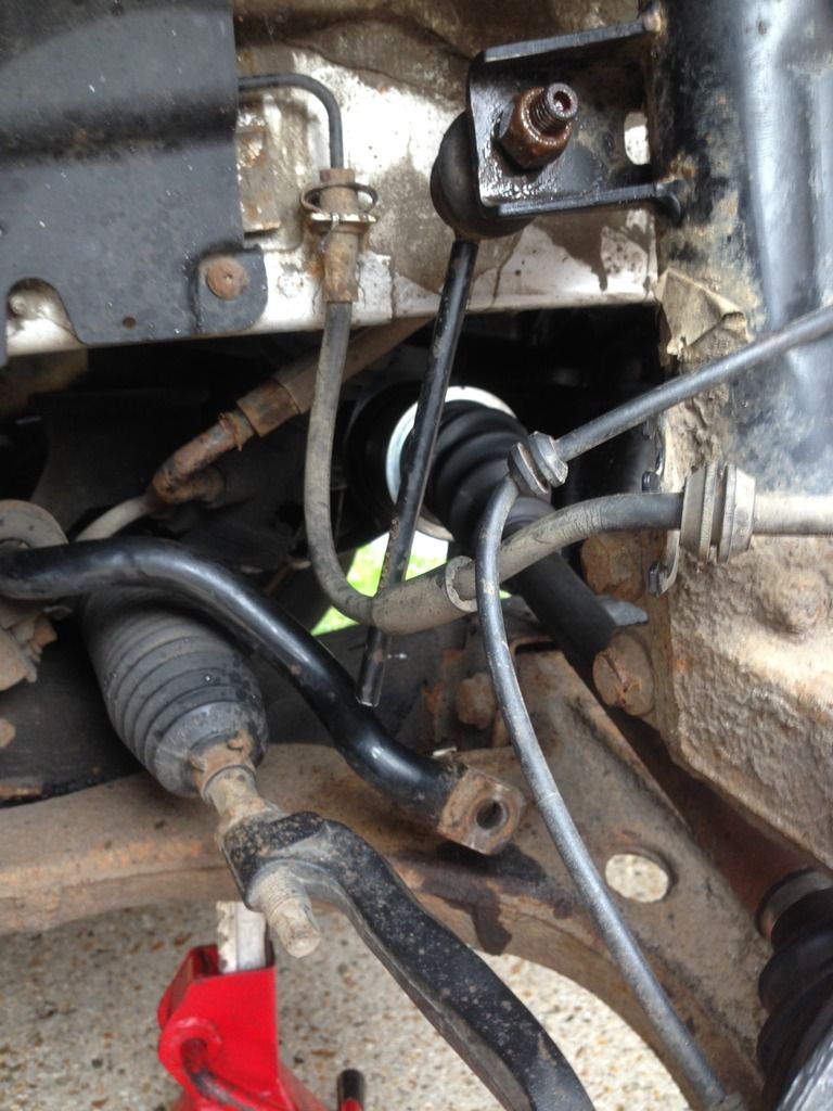

So..... I've been working on the suspension recently over the past couple of weekends. What a :eek::eek::eek: of a job!!
Just completed the front - hoping the rear will be much easier T:
Started by removing the wiper arms - needed a special tool as mine were rusted solid to the spindles. Then removed the plastic scuttle and loosened suspension top nuts.
Then loosened off the 30mm drive axle nut through the wheel hub. Jacked up the van and removed the wheel.
Next up I removed the ball joint mounting bracket using a multipoint bit.
I then turned the steering hard lock and removed the hub nut and drive shaft. I then loosened the strut to hub clamp bolts using a 18mm socket.
I then had a disagreement with the antiroll-bar link which resulted in me having to cut them both with a hacksaw and replace with new.
Next up I removed the brake calliper and separated the steering tie rod ball joint from the hub assembly - this resulted in splitting both plastic boots.
Luckily I had a couple of the right boots in my garage from my Beetle T:
I then used a chisel to open up the hub clamp and hammered it down off the strut.
I then loosened off the rest of the nut securing the strut through the top of the engine bay and the strut was out!
Strut reassembled with hub hammered on - this takes a heck of a lot of hammering - even in this pic you can see it isn't completely home in the hub. I tried two methods....
....Attaching strut to van through engine bay, then jacking the hub up into the strut
.....and simply beating the absolute turd out of the strut and hub with a hammer whilst off the van - both required a lot of hitting and weren't easy. Then reverse reassemble all the other parts. :ILU:
Finished product - I'm considering fitting the rear suspension, but leaving it wound all the way up then getting some chunkier tyres on the rear A:

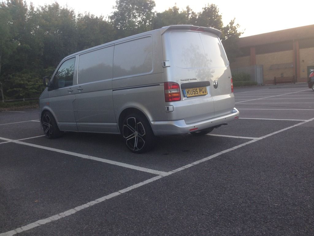

Those wheels look so good, they look larger than 20". I'm rather liking the stance :cool:
Yeh I spent quite a bit of time looking at alloys and was super lucky to net the ones I was after on ebay! Talk about right place at the right time. So much of a vehicles final look is down to the wheels and stance.
