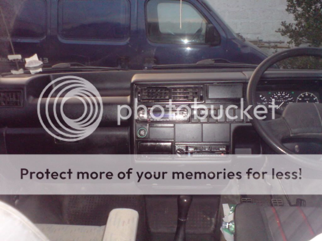

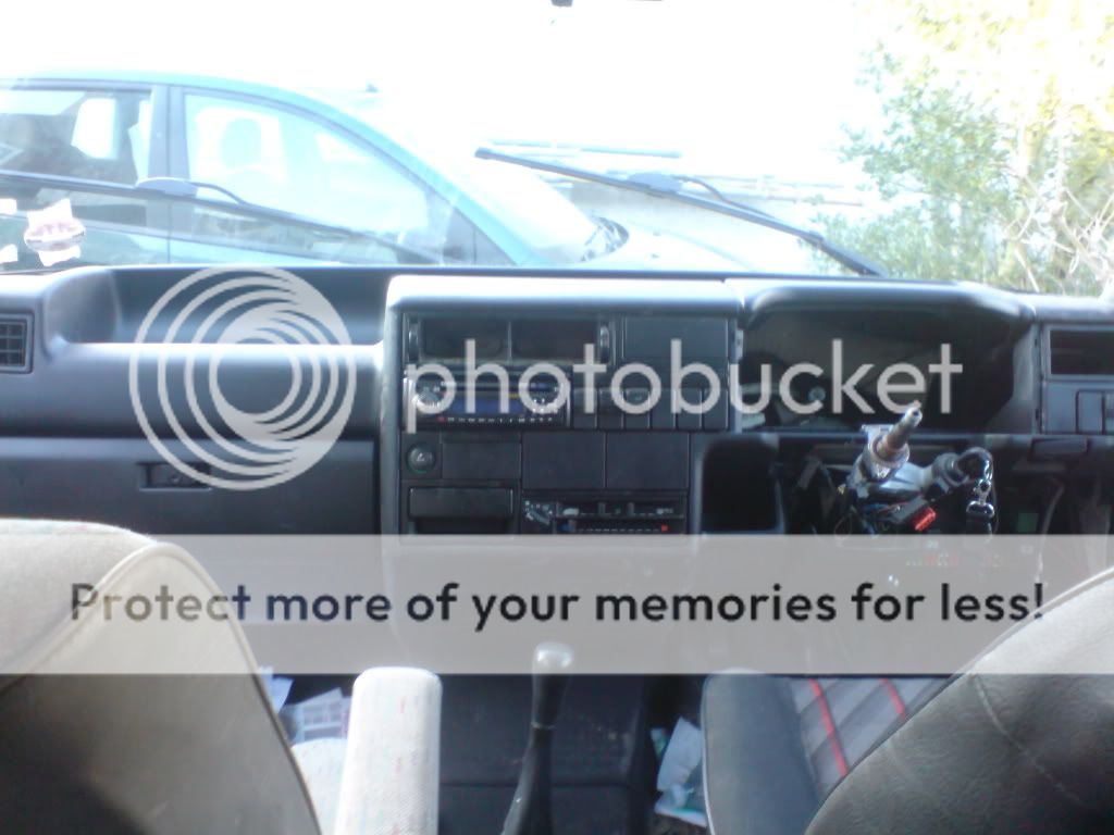

i decided to photograph the series of events as the change was being made. here is the original colour and dash, minus the clocks and the glove box

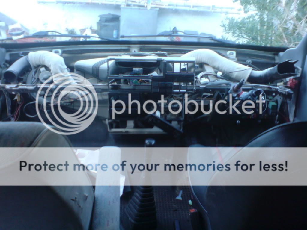

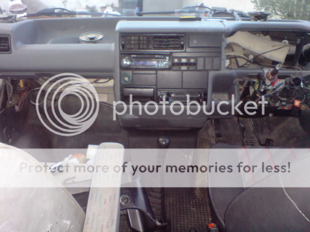

once everything was off, this is what i was left with, it was a bit daunting, but everything seemed to come off nicely. i found that i had to be very patient as there were constantly screws appearing still holding the dash in place. my trick was to pull lightly on the dash and find out where parts of it were still attached, sometimes it was clips and others were screws such as the sneaky little ones that are behind the the heater vents!! but it was patients and this paid off.

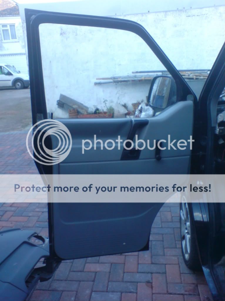

this is the original door card

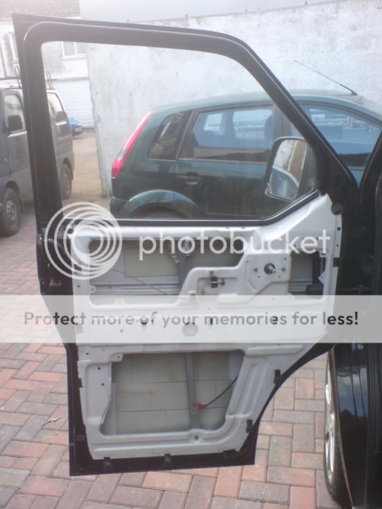

Now removed

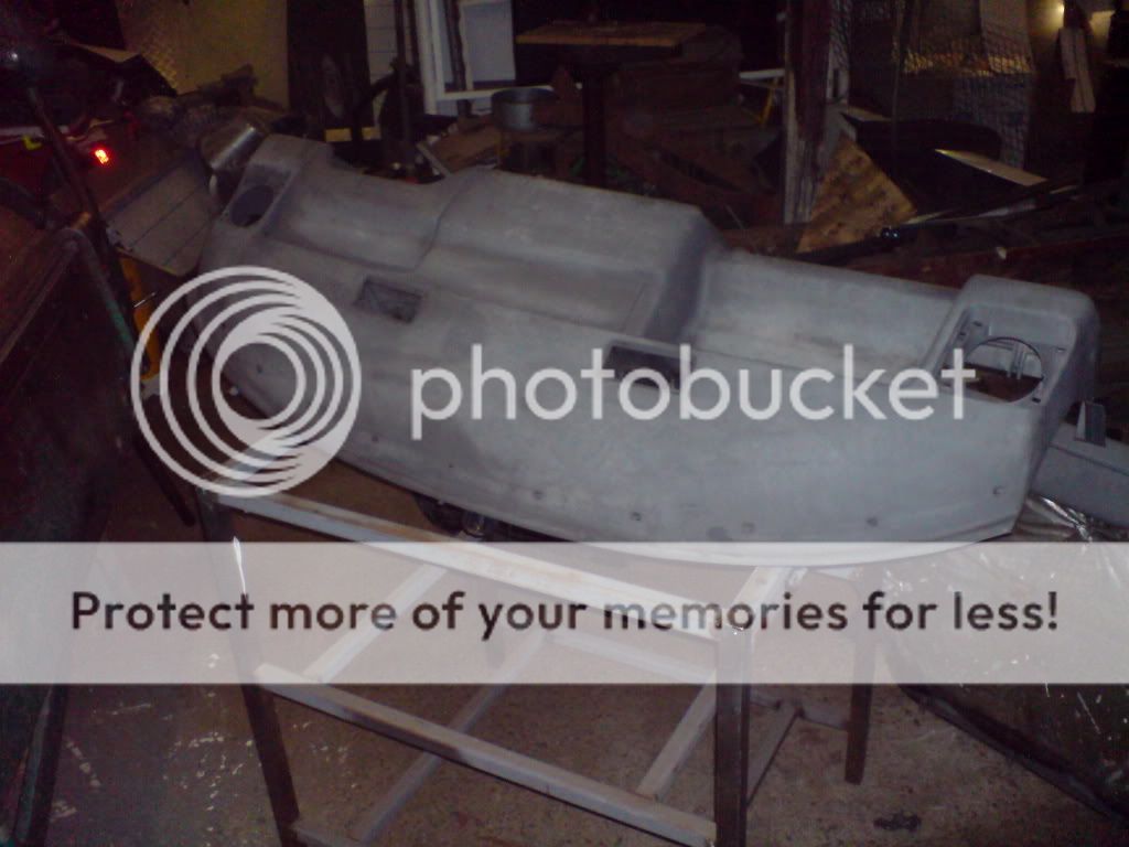

i then took off the other door card and took all the parts to get them ready for paint. i gave them a wipe down with some white spirit and then pressure washed them this was to ensure that they were clean
here some some parts ready for paint

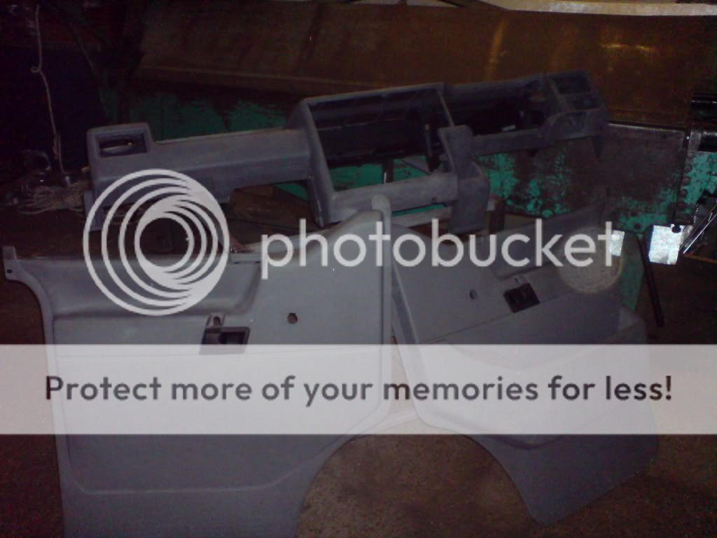

look how tired my dash looks

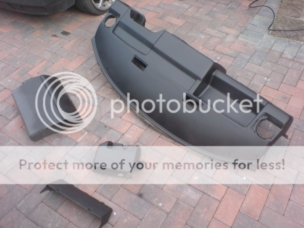

here are the items all sprayed up
they have come up really nice and you can see the difference from when it was grey.
here is the dash going back together.
here is the dash finished all tied up including the dash clocks fixed! i will post a better picture later when i have given the dash a once over with some dash cleaner. but what a difference!!!!!

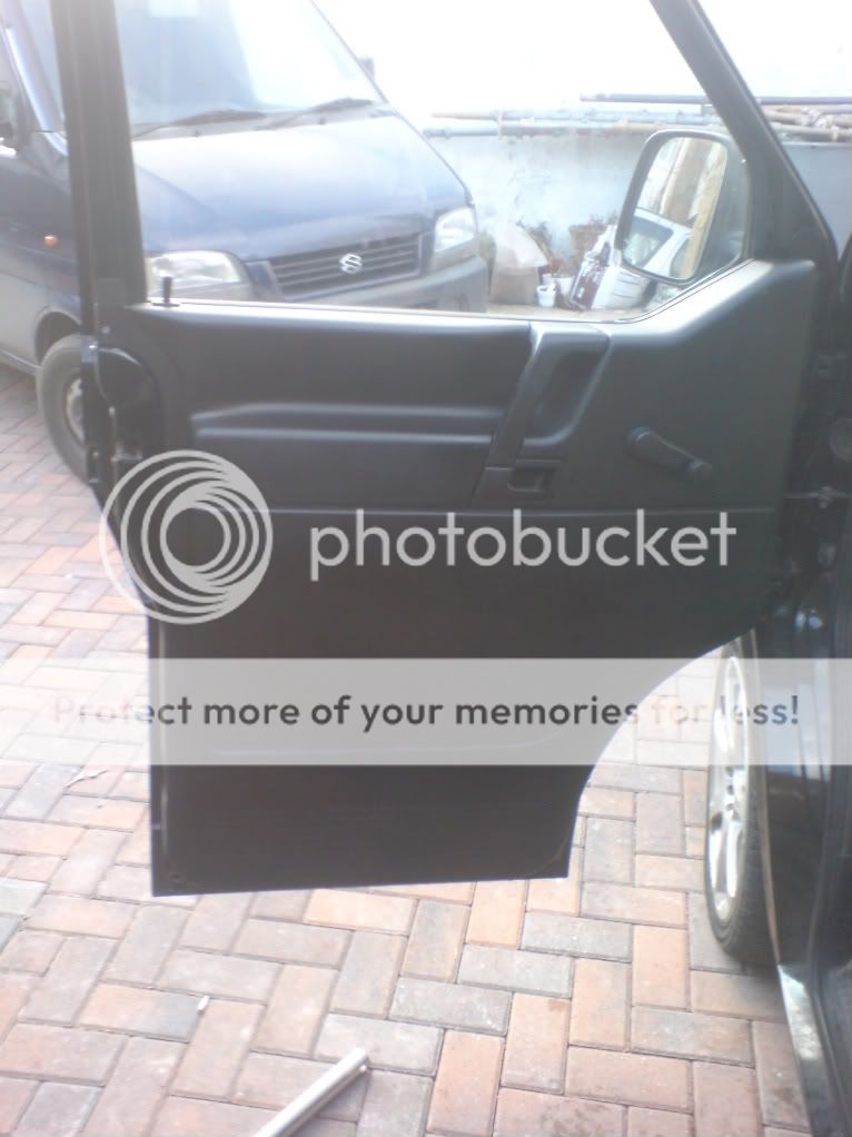

here is the finished door card, i am so happy with the way that they have come out as they look so much better and cleaner.
