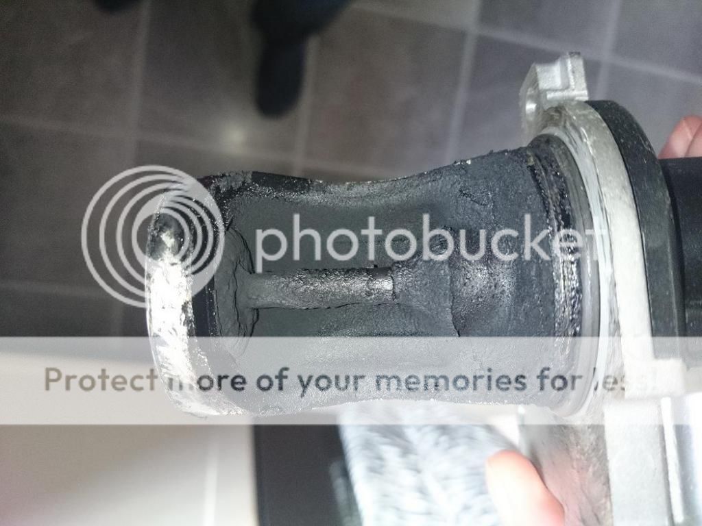

Removed my EGR valve to see if it needed cleaning heres what I found!! And a few pics to hopefully help others. 1.9 BRS engine
Re-fitting is reversing of removing and plug in electrical plug again.
Hope this helps.T:T:

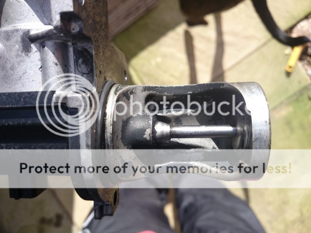

Tried to clean the EGR value to day on my 2.5 TDI and looking at the pictures above it does look like a BCP engine.
I took the cover off the EGR value, only to find that it is the top of the value and I think the electric bits that tell the value to move. I am think the actual valve is the large pipe. A slightly more complex task. I think, unless I am not looking at the EGR value.
I am wondering if this oil is affecting the value moving when it should. The engine light is now only coming on when the its cold, but as soon as its reached its running temperature. I can stop the engine, start again the its disappeared. The ECU is not recording any fault this time. Strange but true!

Hi Rob
Yes thats the egr valve inside will be black. U need to remove black flex pipe on the right then egr cooler pipe at the bottom with star allen key very fiddly try not to drop anything, then remove three bolts on the left u might need new o rings and seal WHT002223 1off WHT002224 1off 069131547D 1off about fifteen pounds from tps got mine just haven't had time to do it. Hope this helps Col
