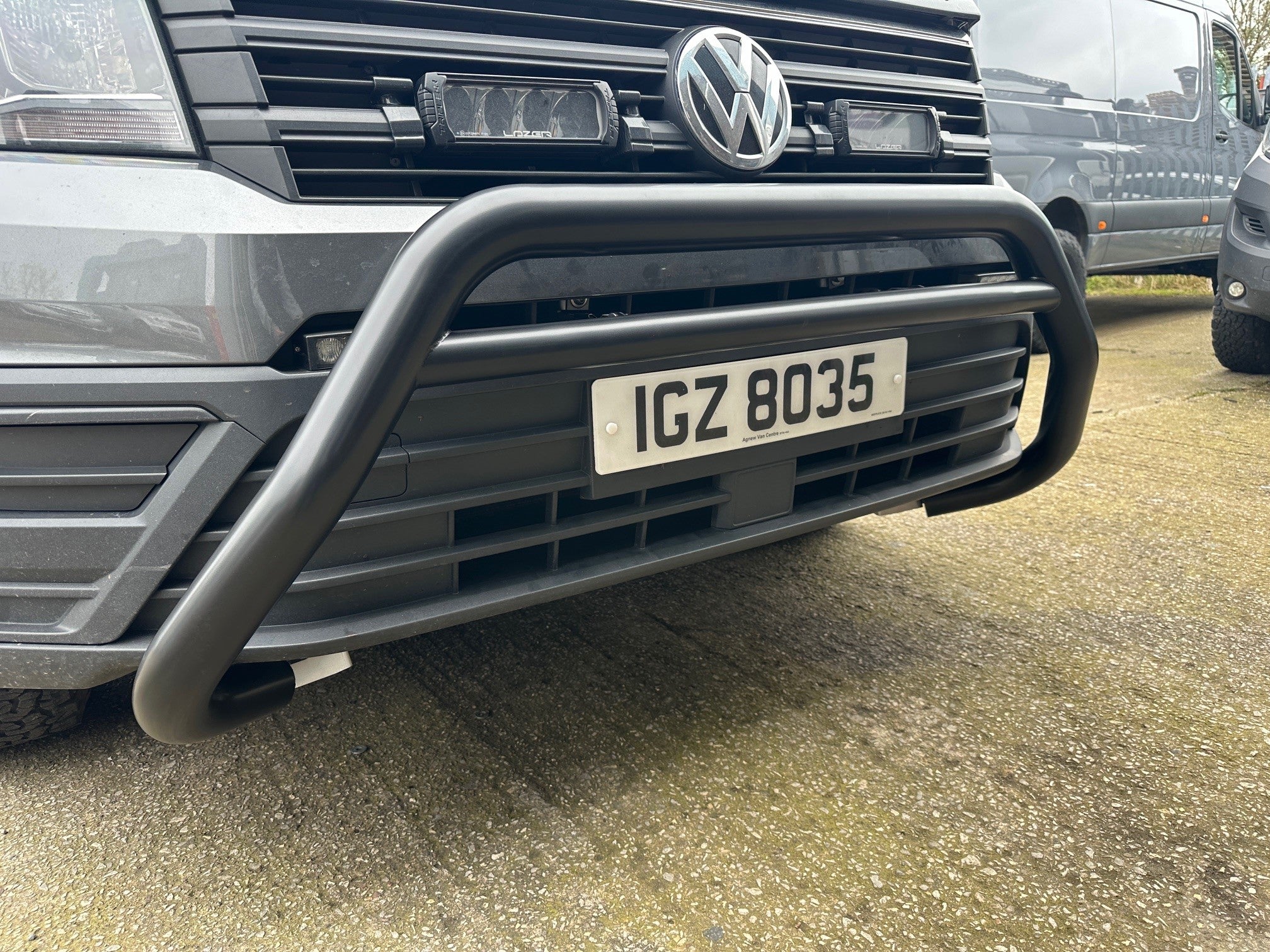

It really is nice gear! My mate has just fitted the bull bar to his new crafter conversion.
He then had it coated to match the colour of his van, even nicer. Not seen it yet, I'll take pics if I can
Not sure I'll ever have enough spare cash to get it, but that roof rack ticks all kinds of silly I don't need it but I want it boxes.
