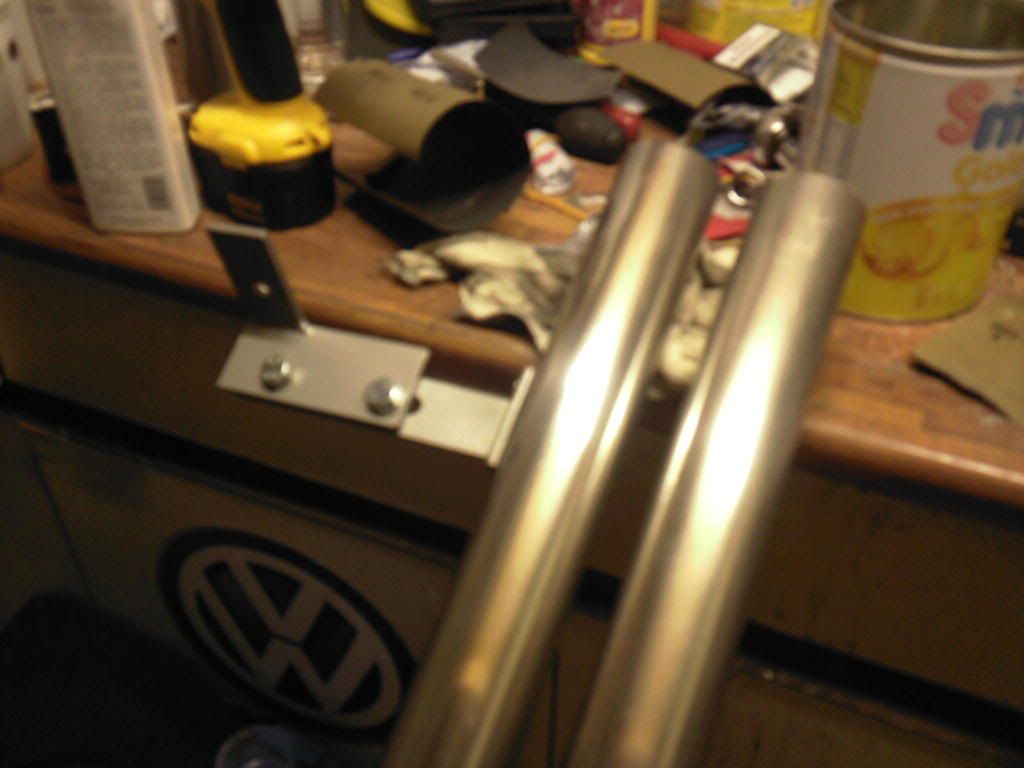

Made all the brackets in work and painted them before bolting them through the pipes.

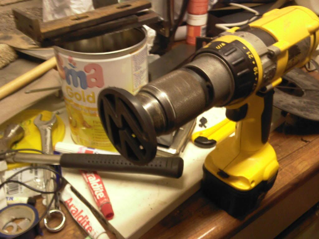

Had a great idea for the end caps!:D
They were a little oversize so I attached to a drill and sanded them down.
Bonded a spray can top to the back and put a dab on silicone on them before fitting them in the pipes.

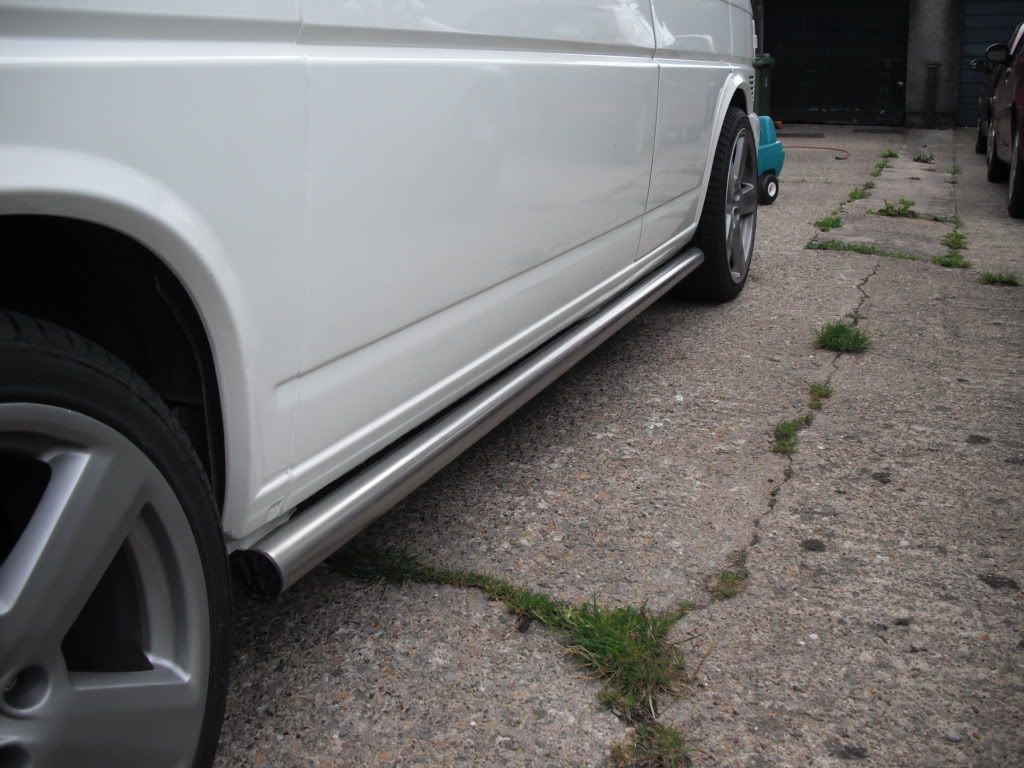

Happy with the result, at a fraction of the costT:

train em young i say :) lol smart looking side bars mate T:
