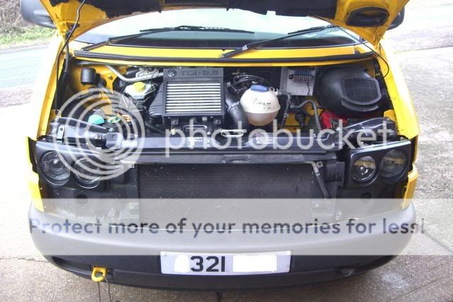

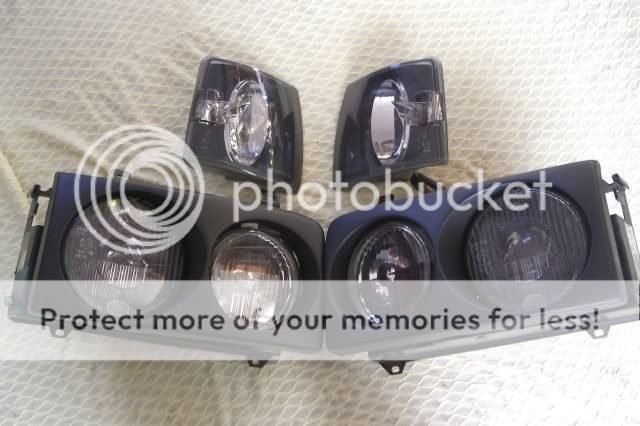

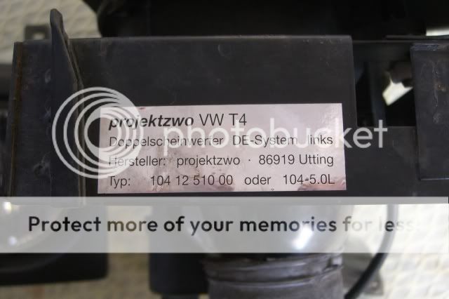

I bought these on a whim, the devil makes work for idle hands I: they where on ebay.de and the seller excepted paypal. Its all to easy just press a couple of buttons and then sit back and weight.
Less than a week and I had the card through the door A: off I trot to the post office only to be given a cardboard box that looked like a pit bull had tried to escape from :eek: There was holes in the side through which poked the mounting brackets and not one corner of the box was intact. In fairness to the seller he had rapped the lamps in corrugated card and used red warning tape around the box which read Fragile Glass, this had come in handy for the courier used it as a convenient handle from which to abuse my lamps by :*
On inspection the lamps survived quite well considering, the only major part that was damaged is one of the motors which has snapped off its mountings.
I hope somebody sells spares or I will have to start make replacements.
I have no idea how old the lamps are or how long they where in production but they look to be a good bit of kit, and after a bit of restoration should come up OK cant weight to get them on the van.:cool:
Andy. *<:)>

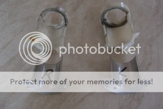

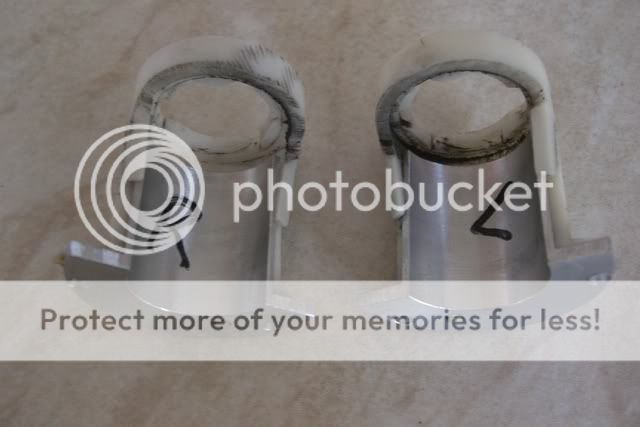

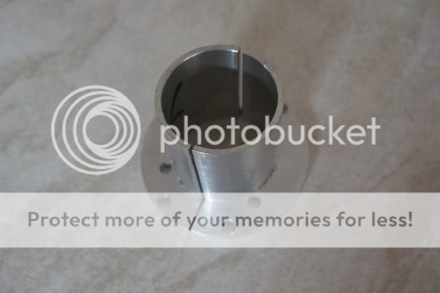

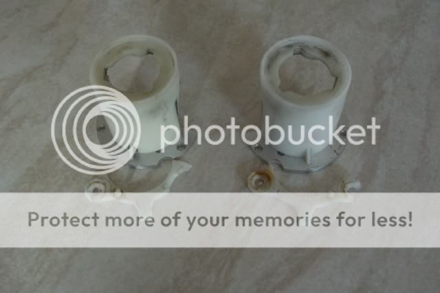

Fixing broken headlight motor housing, I turned a top hat section out off aluminium that fitted up the middle of the original, cut this in half and transferred the fixing hole positions from the original to the replacements.
Now I could cut the bottom broken parts off and glue and screw the alloy parts to the original bits.
The original fixings are a plastic expanding peg securing the motor housing to the headlight body, To get over this I silver soldered nuts to the headlight body.

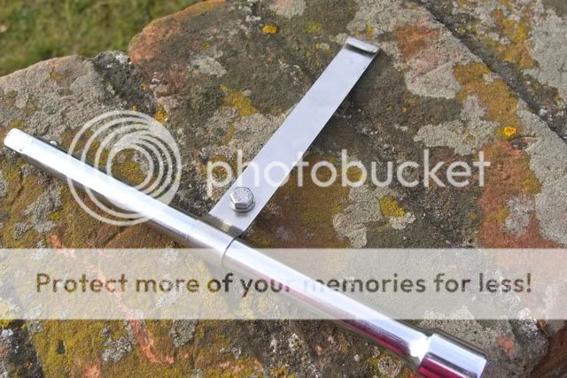

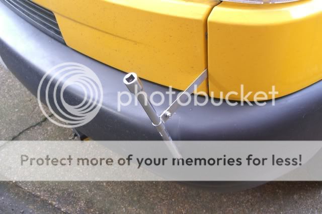

I made a tool to remove the front grill, Its made from stainless bandit strap just thin enough when folded to fit through the panel gap. If you make one remember to leave a gap when folding the metal it will then grab the grill panel securely.

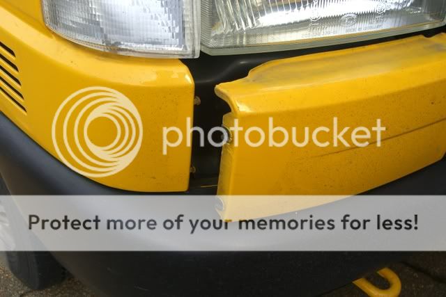

To remove upper grill lower grill and pannel remove five self tapping screws two bottom three top, now insert tool between pannel and pull I mean realy pull !! :eek:

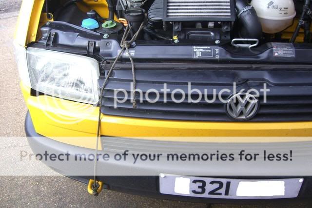

:* Pick your self up off the floor, now that you have one side off TAKE PRECAUTIONS I: TIE A ROPE FROM BUMPER TO ENGINE BAY this will stop grill and panel from ending up on the floor with you when you pull the other side off.
Its off. A:A:

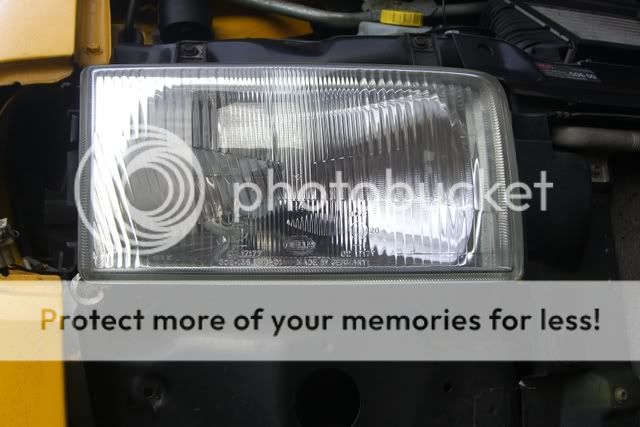

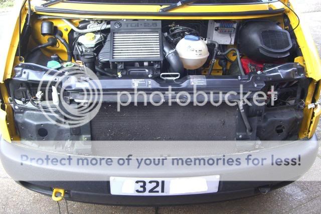

Now its just a case of swapping over the lights, each one is held on with four self tapping screws remove these and disconnect the electrical connections.
Now connect the electrical connections of your new lights and screw to the body of the van, the light fixing brackets have slotted holes in them, these allow a little movement CHECK THE BONNET CLEARS THE LIGHT SURROUND tighten the screws.

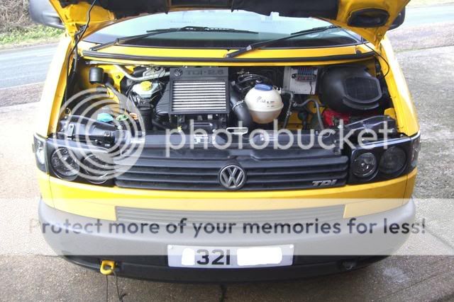

Fit the grill and panel back on, grease the fixing positions first. T:
Job dun now sit back and admire. :cool:

Thanks very much, ...... all i can say is you sve me a new front end, as i was near removing it with a hammer :-(
The pictures are great, I imprivised a bit and rather than make my own tool I managed to jam a few zip-ties down to make a good base, then pulled, then as you say, really pulled............. and they came off!...............One side at a time mind as i say your photo of securing the other side first was legendary....... very good tip as I would imagine that many newly sprayed fronteds would meet the tarmac.
