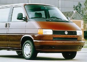

1993 model T4a 2.4D na and 2.5 Petrol Syncro Caravelle.
The four wheel drive T4 Syncro range is announced, built in-house at Hanover with it's own 02D 5-speed manual gearboxes (with no automatic option), available in both swb and lwb bodies but only with the 5 cylinder engines.
Bosch antilock braking (ABS) and Electronic Differential Lock (EDL) is also available across the range, being an option for the Syncro along with rear differential locks and/or a freewheelling device for the rear axle.
T4a Eurovan - note the beefier front bumper in Bordeaux Red.
The 2.5 litre Petrol (AAF and ACU) automatic Eurovan range is introduced in the United States and mexico; the 7 seater Eurovan CL and GL (aka Caravelle) compete in the Minivan sector whilst the MV (Multivan) and the MV Weekender (Multivan with Westfalia elevating roof - Pop-Top) step into "replace" the Vanagon Camper (the California is not offered). Manual transmission is briefly available on the entry CL model.

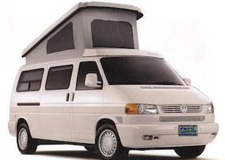

Volkswagen of America (now Volkswagen Group of America) offers the Full Camper built by Winnebago Industries of Iowa to properly replace the Vanagon Camper. Based on the lwb WV2 window van chassis, it has side windows cut in and fixed in a traditional manner rather than using flush bonded factory windows.
Winnebago also builds the Rialta, a sleek 2 berth coachbuilt model based on the WV3 single power cab and leaf sprung rear chassis - both models are powered by the same 2.5 litre 110bhp petrol engines with 4-speed automatic transmissions as the rest of the Eurovan range. Both models are exported to Canada as Eurovan models.

Eurovan MV Weekender, Full Camper (shown) and Rialta now with long nose and 6-cylinder 140bhp VR6 engine - but still automatic only for the United States.

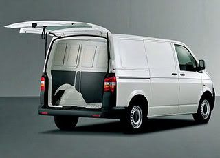

The last T4's are produced alongside the new T5 from March 2003.
No T4 engine or gearbox directly carries over to the T5: all T5 4-cylinder 1.9 litre (84ps and 104ps) and 5-cylinder 2.5 litre (130ps and 174ps) diesel engines are Euro 3 Pumpe Duse (PD) with higher outputs; the 4-cylinder 2.0 litre petrol (114ps) now has Motronic fuel injection and the V6 is now enlarged to 3.2 litres (235ps).
The New TRANSPORTER
  • T26 Panel Van - swb; low roof only; 802kg payload; 4-cylinder 84ps TDI PD engine / 114ps petrol engine (not for the UK); 5-speed gearbox
  • T28 Panel Van - swb; low or medium roof options; 1002kg payload (4-cylinder 84ps or 104ps PD engines; 5-speed gearbox) or 928kg payload (2wd 5-cylinder 130ps or 174ps PD engines; 6-speed gearbox)
  • T30 Panel Van - swb or lwb; low, medium or high roof options; starting at 1202kg payload (4-cylinder 84ps or 104ps PD engines; 5-speed gearbox) or 1128kg payload (2wd 5-cylinder 130ps PD engine; 6-speed gearbox or Tiptronic gearboxes or 174ps PD engine with 6-speed gearbox) or 1028kg payload 5-cylinder (130ps engine; 4MOTION).
  • T30 Window Van - swb only; low or medium roof options...
  • T32 Panel Van - swb or lwb; low, medium or high roof options; starting at 1383kg payload (4-cylinder 104ps PD engine; 5-speed gearbox) or 1309kg (130ps PD engine; 6-speed gearbox)
  • T32 Window Van - swb or lwb; low, medium or high roof options...
  • T30 Chassis Cab - lwb only; single cab or doka; 4-cylinder 85ps (not for doka) or 104ps PD engines with 5-speed gearbox or 5-cylinder 130ps PD engine with 6-speed gearbox.
  • T30 Power Cab - single cab or doka...
