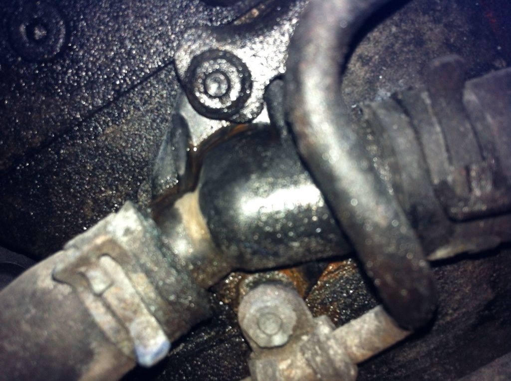

Think I've found part one of my water leak. Below is the picture of where we can see the leak... It's coming off the housing near the top nut. If you can't tell this housing is on the right hand side of the cylinder head above the gearbox!

Yeah that's it mate. Just need to find what it's called to order one!! And any ideas where the rad fans fuse is hidden?!
