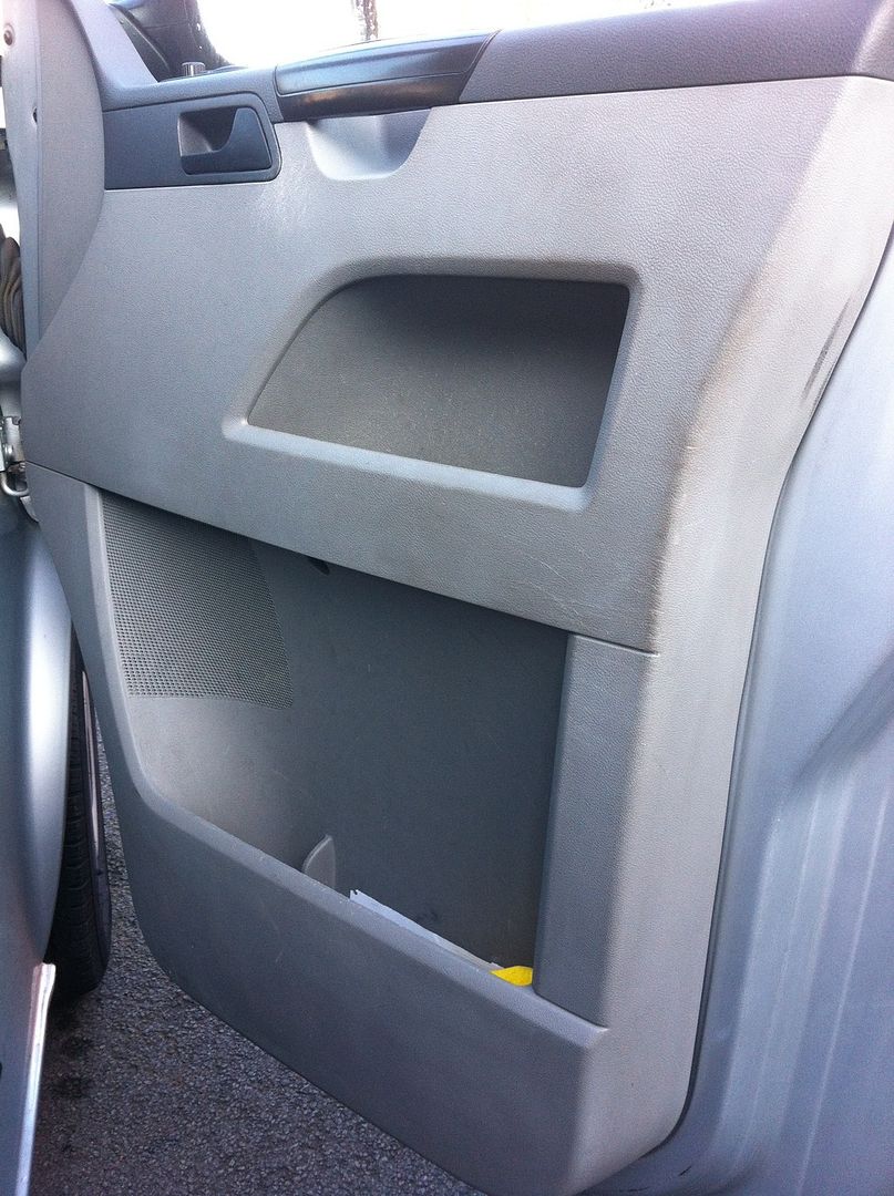

So my T5 door cards are pretty cacky and cratched so at some point I would like to cover them with something to help make tha can area a little more plush and soft if you know what I mean!
Thought about flock or the stretch carpet lining used in the back...
What are your experiences, failures or successes on tackling this? Post up your photos too please, here's my scabby sort cards to start it off...
You can't do any worse now!
