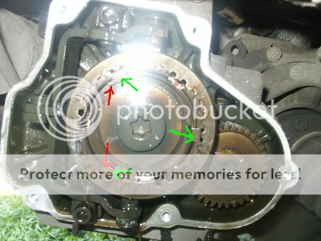

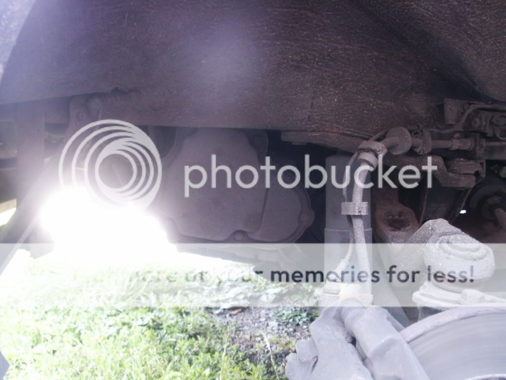

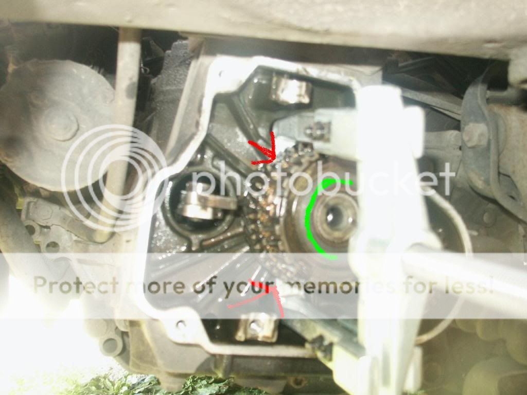

if your end cover is like this then you can do the conversion

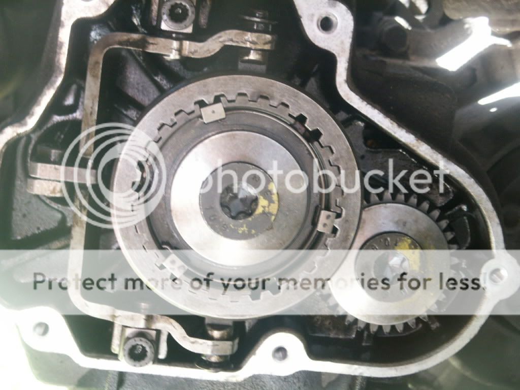

this is as is when the cover is off & you need to remove the big spring clip to get the syncro out spring marks in red & the locating blocks marked in green,these hold the syncro together

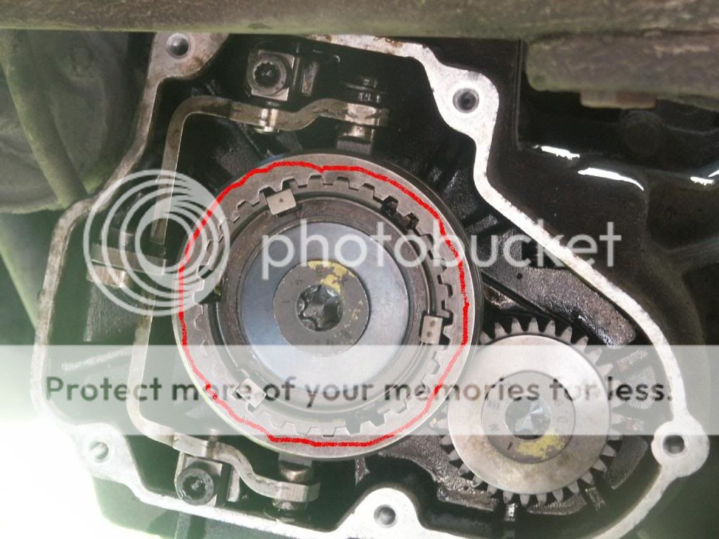

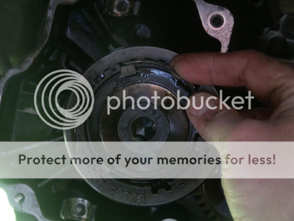

syncro housing marked in red

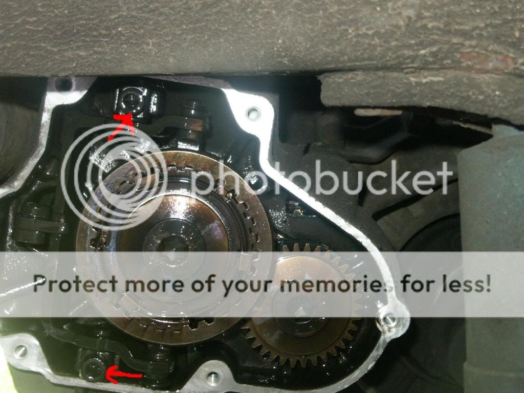

undo the two 12 point bolts that hold the selector folk in place bolts marked red
unclip the spring & hold the housing whilst holding the 3 syncro blocks & slide the lot off the gear

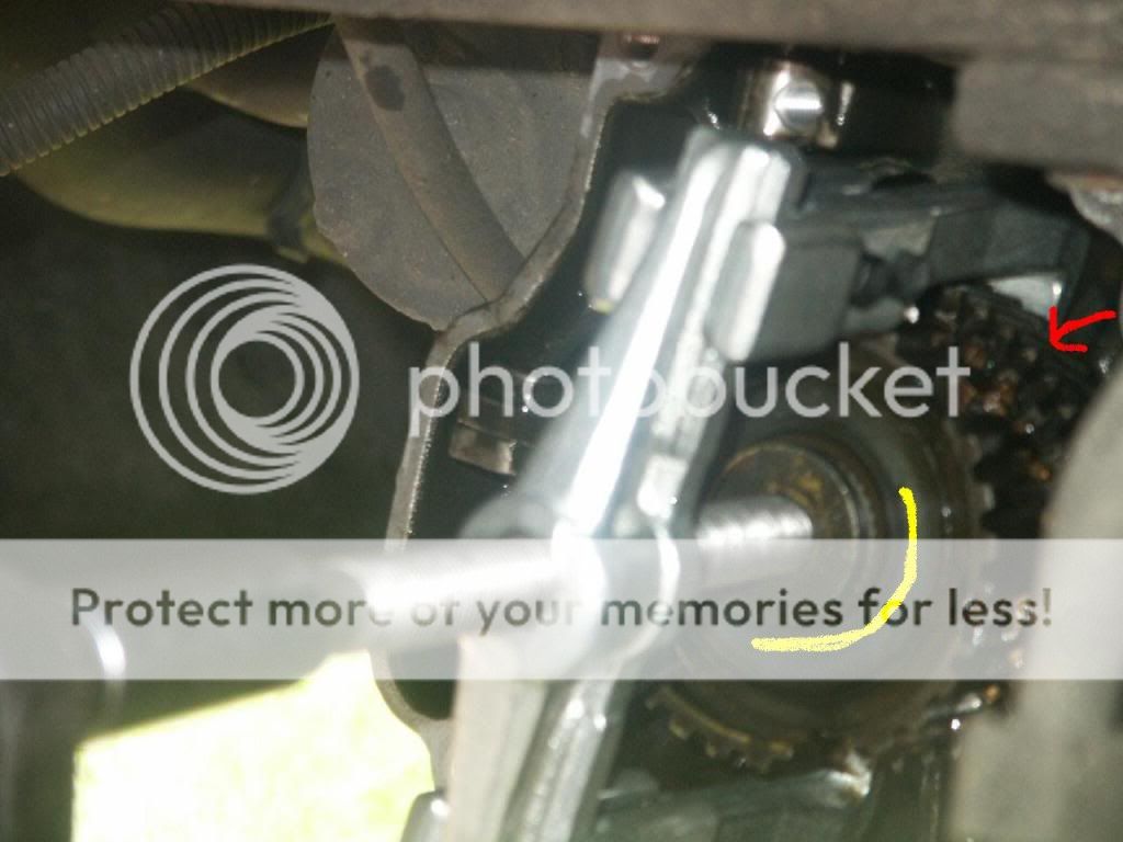

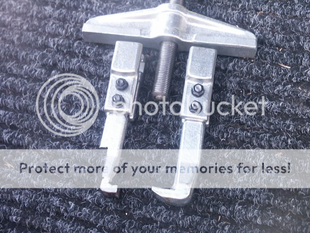

the red section shows where i put the 2 leg puller & the green section show the part of the gear to heat up with a blow touch "Its A Must To Ease The Gears Off"
appily tension to the puller then give the gear a good old heating then apply more heat & so on
slightly better picture & you must put the gear bolts back in there threads while using the puller or you will damage the shaft threads

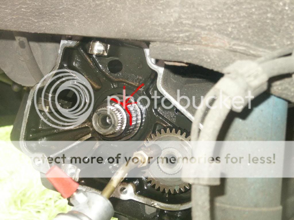

this is what it looks like once removed & note the red section marking the needle roller bearing,,again this will slide off know probs be careful its breakable,,also note iam getting the small gear warmed up ready for pulling,,again same method appies for pulling this gear as with the big gear
this is what i had to do to the puller to get it to fit in between the back of the gear & the gear box housing "Theres Know Other Way I Could Get In" picture shows one leg modded but you will ahve to mod both legs with the angle grinder & a "Slitting Disc"

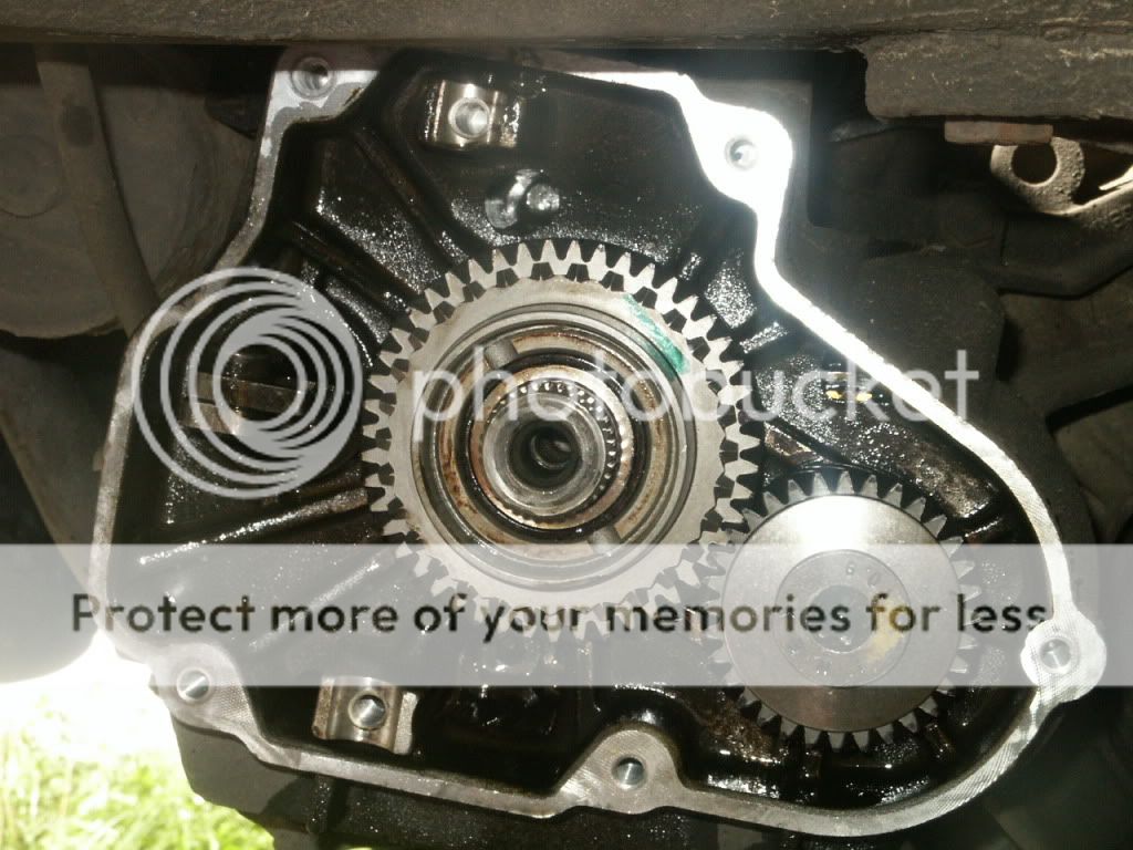

Its the syncro gear that needs heating then pulling home "Not" your new big gear,that can be fitted along with the needle roller first
this shows it all together,but i will try to explain the syncro blocks as i call them & the spring clip its riddly but do"able you need to slip them over the spring thats built into the syncro hub then sort of open them whilst fitting the spring clip they will resist thats how they work/hold it all together it sounds harder than it is,,once thats on fit the syncro folk,i got my mate to work the gear lever "Verrrry" slowly sort of going for 5th but not just to aid the selctor folk then once she is in bolt her up & get ya mate to select 5th if the syncro hub goes inwards towards the gear box your cooking on gas,,i got him the go for 5th at least half dozen times till i was happy with how it looked & sounded.

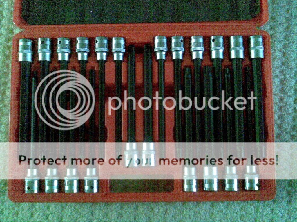

i bought one of these sets knowning i did "Not" want to get stuck,i paid £42 for it but it will come in handy for other jobs on the van
sorry about the pics "Mobile Phone"
note the bit on the left as 6 points & the bit on the right as 12 points
folk think torx are torx there not,this kit as 3 different types & your Vw T4 van gear box uses two of them
