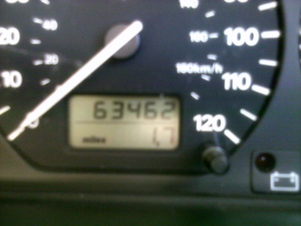

Hi guys,
Having picked up my van from T4 Virgin last weekend, I thought it was finally time I signed up as an offical member (if you will accept me!) of Team White. So here is my shiney new (to me) S reg 1.9TD transporter, 63000 miles young and running sweet. I flew up on Sunday and after a quick look around the van it was as good as I had been hoping for, so after after parting with my hard earned money, I filled it up and headed for home.... after 15 minutes I realised I was going the wrong way, so turned around and headed south!!
