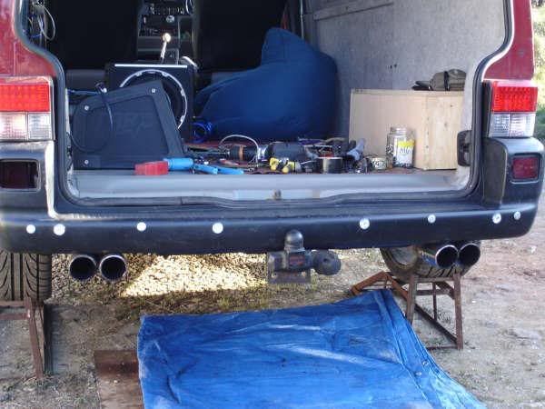

rear bumper

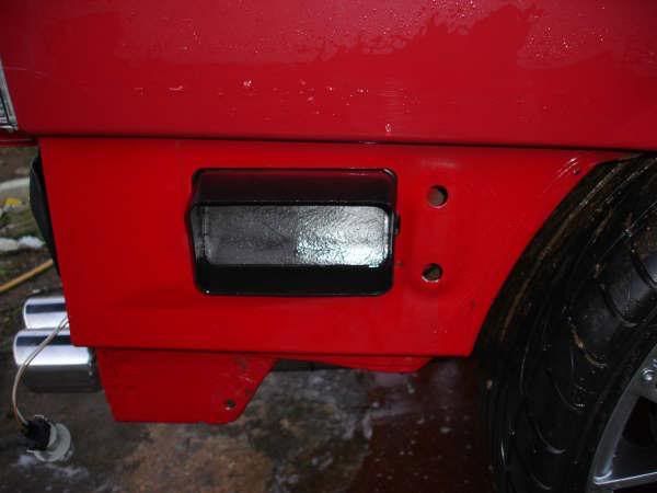

rear drivers side before bracket

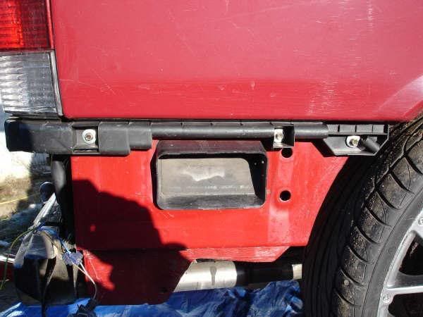

same side withbracket fitted.
and the steel in place.
as i stated before leave the old center section in place its a lot easier than fitting this steel work due to the 2 threaded tubes that the spare wheel carrier bolts go in are in the way.

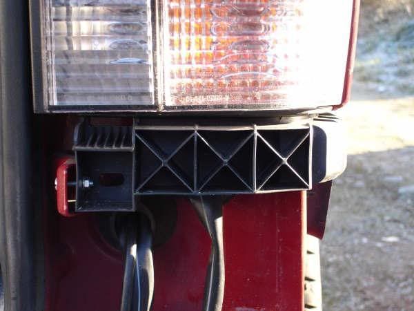

this is a pic of the steel brackets the hold the old center on.
and the bumper on.
thanks to ratboy. got it on eventually pard.T:
