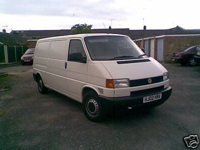

Van as bought.

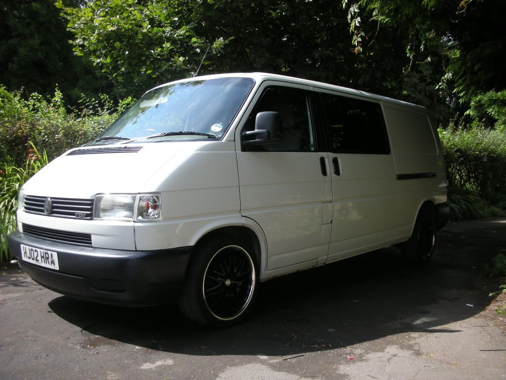

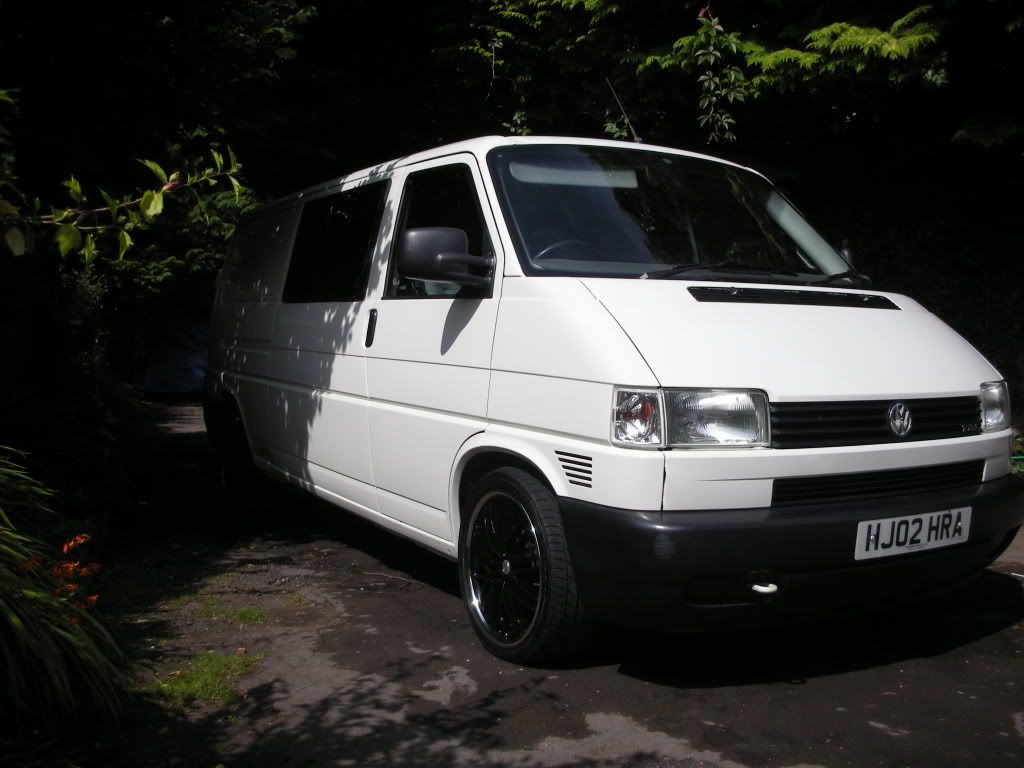

Then new wheels and windows, clear indicators,wind deflectors, lowered front (waiting till interior is in before doing back).

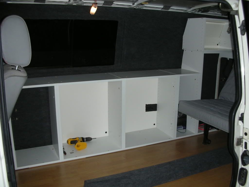

Then carpet,floor and units in.

Couple more things done today, installed my Waeco CR50 fridge, £250 brand new cause it has a small dent in the door, but I struggle to notice it so im well happy with it. The fridge is quite deep so I had to pull the unit forward a bit to fit, ended up pulling unit next to it forward as well as it looks a better. The unit that houses the fridge is the ikea 400mm wide wall unit but the inside dimension is 360mm and the fridge is 380mm, so I had to widen the unit slightly using a couple of strips of 18mmx34mm batten. I'll be getting a 500mm door for this which ill cut a hole in the size of the fridge so everything is hidden and flush.
Also installed my led leisure battery monitor in panel next to sliding door, this was a bargain at £5.99 inc postage from hong kong, installed a push button switch next to it to turn it on and it goes off again when the button is released.
