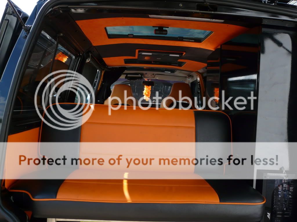

Here you go buzby3xx my roof in Alcantara. This stuff is lovely to work with, and gives a nice smooth look (i think) leather looked a bit heavy on the roof, vinyl looked a bit cheap, painted and smooth panels looked a bit chav and carpet is well carpet! Finally settled on alancatara, really pleased with it, really looking forward to doing some more stuff with it!

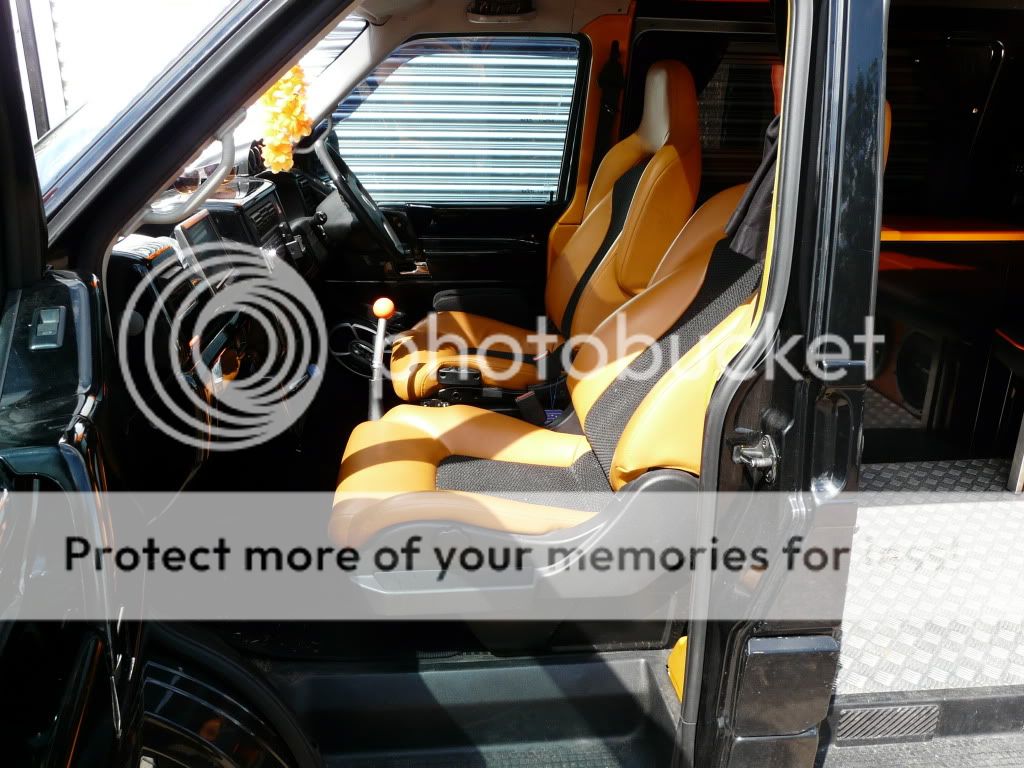

Also dropped in some 350z seats, not exactly bright orange but near enough, really cant stand the colour of them, will have to get them done soon, when i am not so skint:eek:
Its a bit bright hey:ILU:

:ILU: took a full on week to re do it, when i say a full week i mean 9am till 1.30am the hours just fly byI:
think its a bit to bright now:confused:

I've been shopping around for Alcantara too. You can get the faux stuff cheaper but in limited colours. What is it like to work with Will? Is there any stretch in it to work round corners etc, could you do the door panels for instance, and have you used spray glue to hold it? T:

Awesome stuff to work with, it will stretch to do door cards and stuff, stuck on with contact adhesive spray glue.

Nice, I went for the boring grey. Its lovely material and worth every penny. If you are going to trim something with alot of shape to it the i advise you to use the "unsupported" version (without a backing on) but if you are using it for seats or the bed the get the type with the backing on, it stops the material going baggy over time and use. the Uk importer of geniune alcantara is boyrivern or boydrivern or something like thatI:
The best type of faux alcantara with lots of choice in colours is called dynamica theres a few places that sell it on the net. Over the years i've used both for various things and the genuine item is the best but for nearly 3 times as much per meter you'd expect so.
