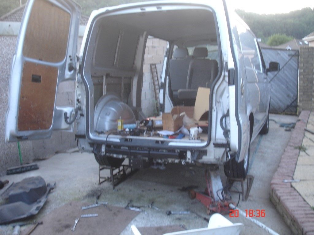

First mod as to fit a towbar, I bought a complete kit from PF jones and got it fitted- still need to get it coded with vag com for the tell-tale on the dash
straight forward to fit

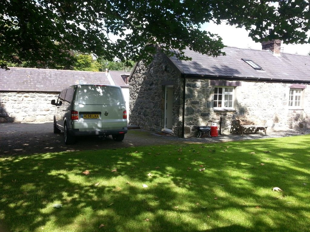

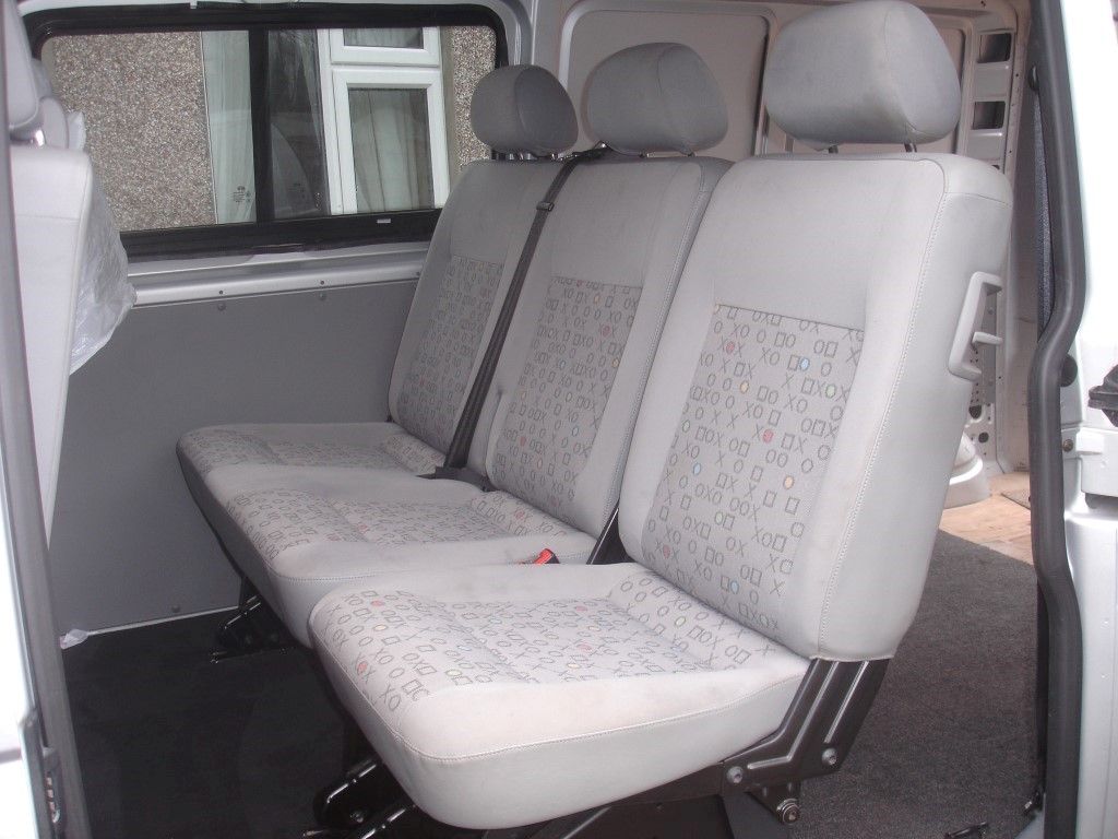

Picked up a caralelle front bumper and head lights, a set of range rover alloys and got the windows fitted professionally-fitted the seats that I removed from the t4 when I sold it and then took it up to North Wales last summer with the kids for a holiday
BlackRock sands where the kids had a drive:eek:
the cottage we rented for the week
off to Blaenau Ffestiniog for a bit of mountain biking and zip wire slide, our son with the van
