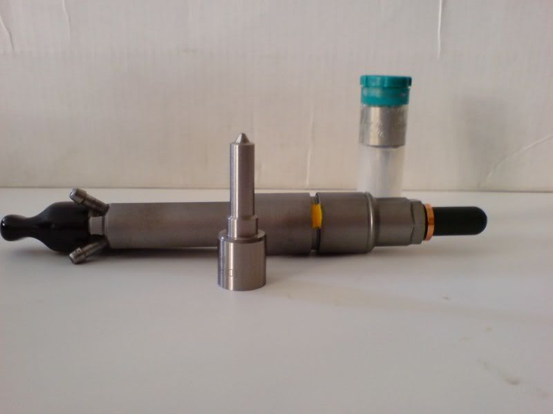

fig.3. - Projekt Power Injector complete next to a nozzle

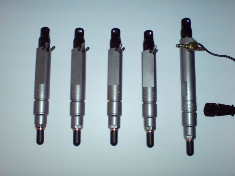

Fig.4. - Full set of fully recon Projekt Power injectors fitted with Projekt Power Nozzles

Injectors and Nozzles are the heart of Projekt Power.
Anyone with a basic grasp of mechanics can perform the change out. Its only nuts and bolts and being clean and not losing the contents of the injector. (Note - this onky applies to ACV engines as the AJT injectors come with nozzles prefitted).
The entire job should only take a few hours at most. What you need to do is to remove the injector bodies from the engine. To do this you need to undo the union nuts on both the injectors and the fuel pump. Then you need to extract each injector by undoing the clamp that secures it to the engine. Then you use a 15mm open end spanner to twist and pull the injector out of its hole being careful not to lose the sealing washer on its end.
Once the injector is out you need to hold it upside down in a vice to remove the nozzle cap. The nozzle will come out with the cap and then you need to tap the end of the nozzle to get it out of the cap. Its important not to spill the contents of the injector body out so keep it upside down in a vice to avoid this occurring.
You then locate the new nozzle on the locating dowels on the other half of the injector body and screw on the cap. The its merely a case of replacing them into the engine. Connecting the needle position sensor wire and you are done.
Note! On AJT engines the needle position sensor is on cylinder 4. On the bosch injector its on cyl. 5. all you need to do is install the new injector (Bosch) with the position sensor into cyl. 5 as opposed to cyl. 4 and then connect the wire to the loom which is behind the engine from the underside.
