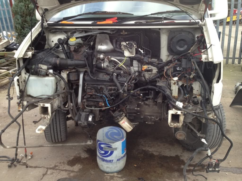

started stripping the van out

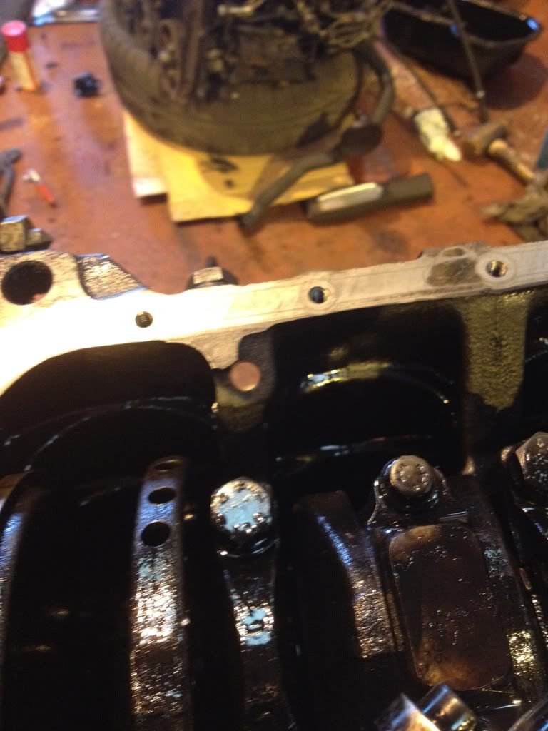

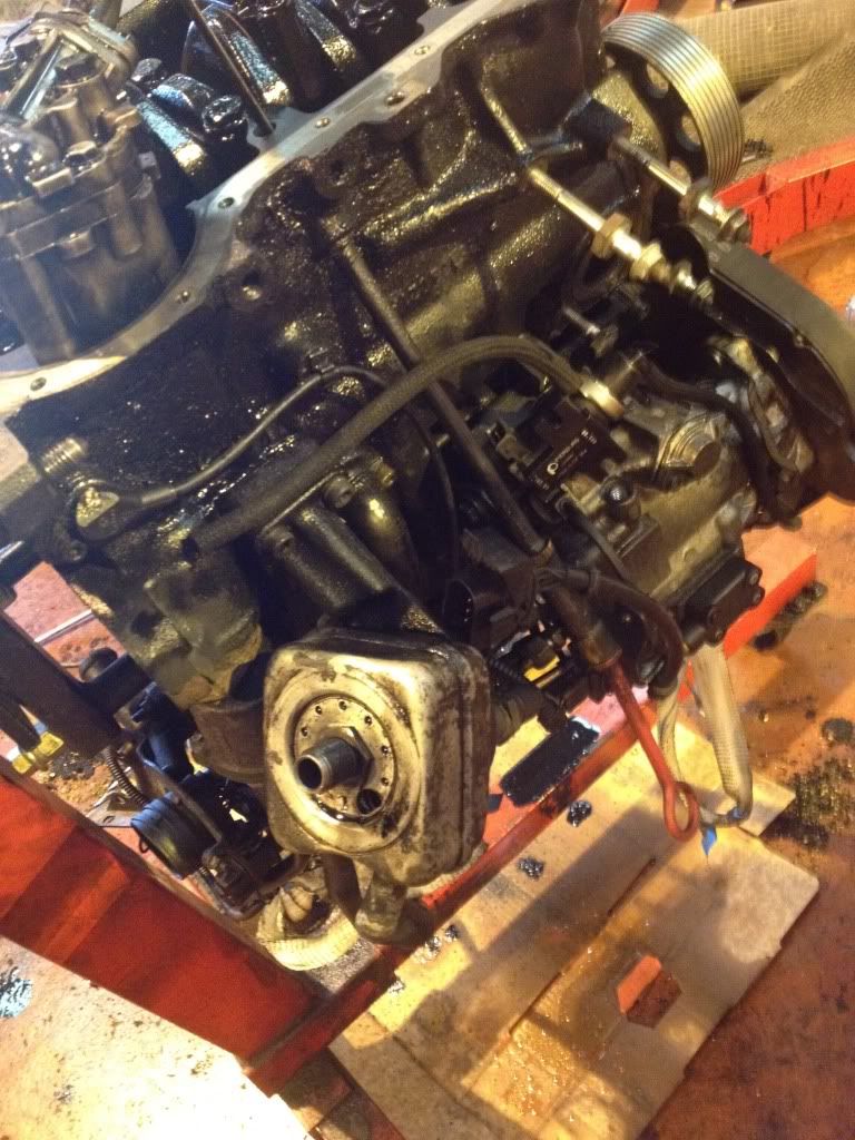

removing sump and oil pick up tube from AHU and fit oil filter housing from the ABL i also fit the ABL power steering pump, alternator, inlet and exhaust manifolds, sump, pickup tube, vac pipe, water housinh from the side of the head,
i used the AHU flywheel and clutch.
drilled the new dipstick tube, i just left the AHU dip stick in place, drilled and tapped the new engine mounts i also took the time to tap out all the bolt holes that will now be used.

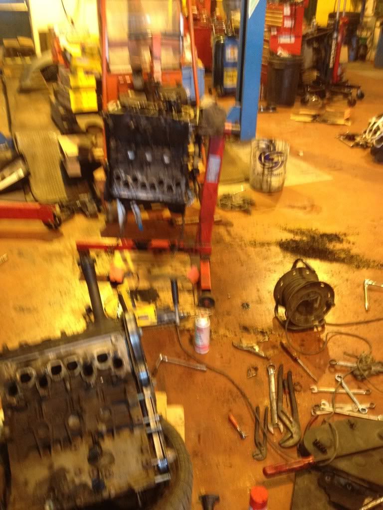

Carnage took some right mopping up

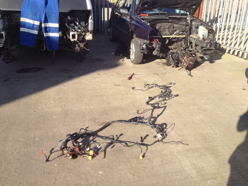

loom out of the golf (took an hour) stripped all the loom apart follow the guide its simple...T:
would definatly invest in the 2.5tdi pedal and bracket makes the job a little easier.
