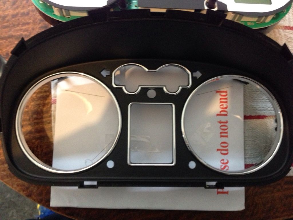

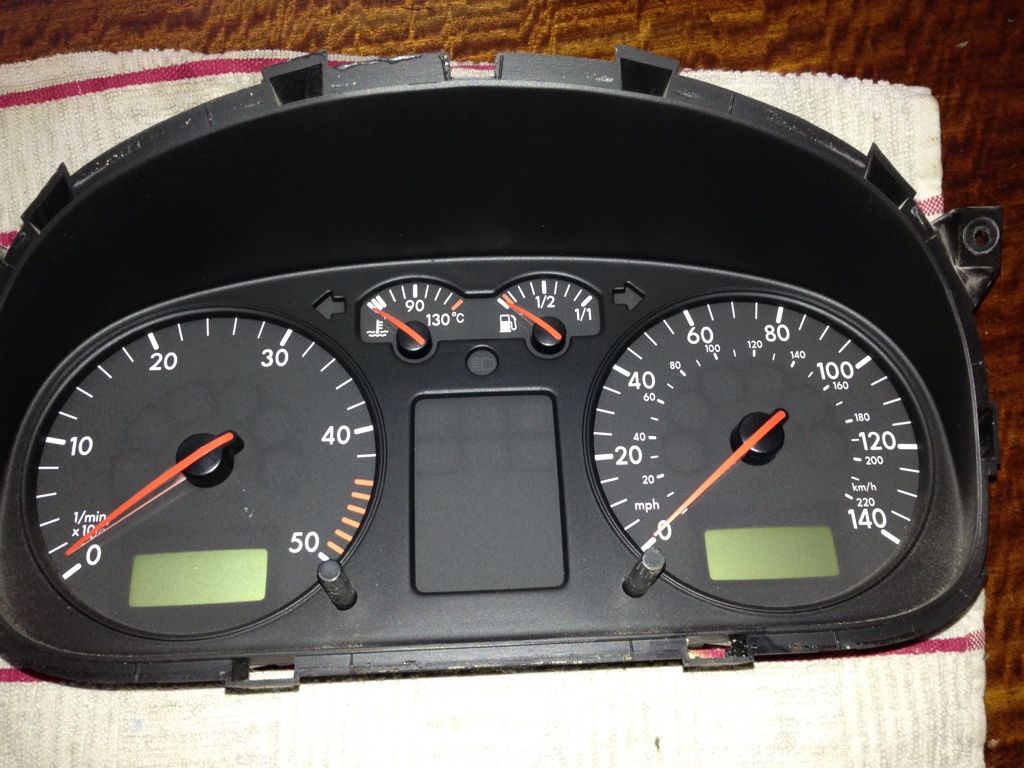

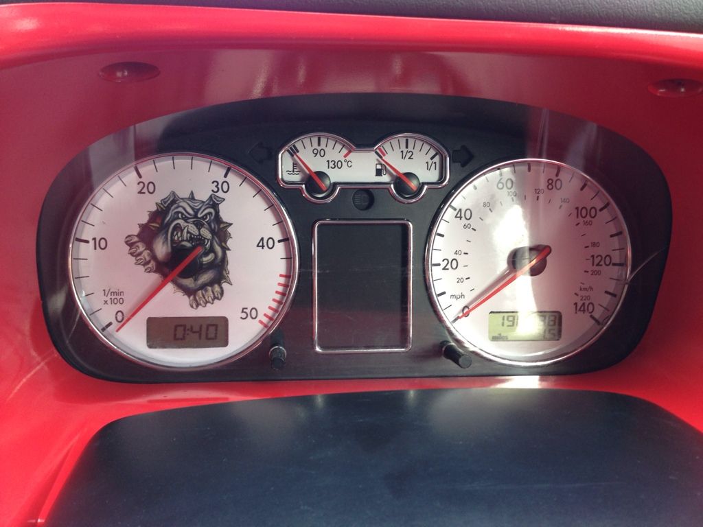

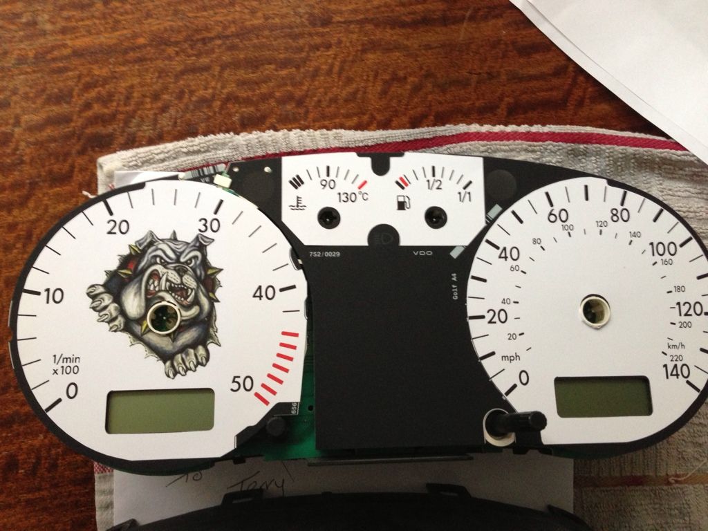

Fitted a new set of dial rings and renewed the speedo faces , i read a hundred threads on how to do it from removing the dash , taking out the vent and removing the steering wheel none of which i did . 6 screws was all i had to undo and unclipped 2 plugs at the rear of the cluster .The cluster slipped out past the steering wheel with no trouble . It took a matter of 15 minutes to do . Even the dreaded needles popped off with the help of 2 spoons
Well worth a hour of my day i think

Now they look Good ! How easy was it to remove ? can you do a idiots guide how to so I could have a go please. T:
22 Posts
very easy 2 screws under the steering column 2 screws on the top of the cluster insert then 2 screws on the cluster
Pull it forward reach behind and unclip the 2 plugs easy as that T:
1,537 Posts
6 Screws in Total I think I should be able to manage that... Why have I read on here in the past that its such a complicated job ? Sounds a piece of p###.
