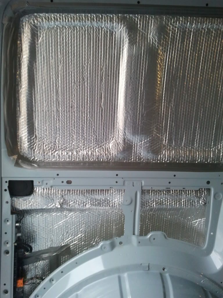

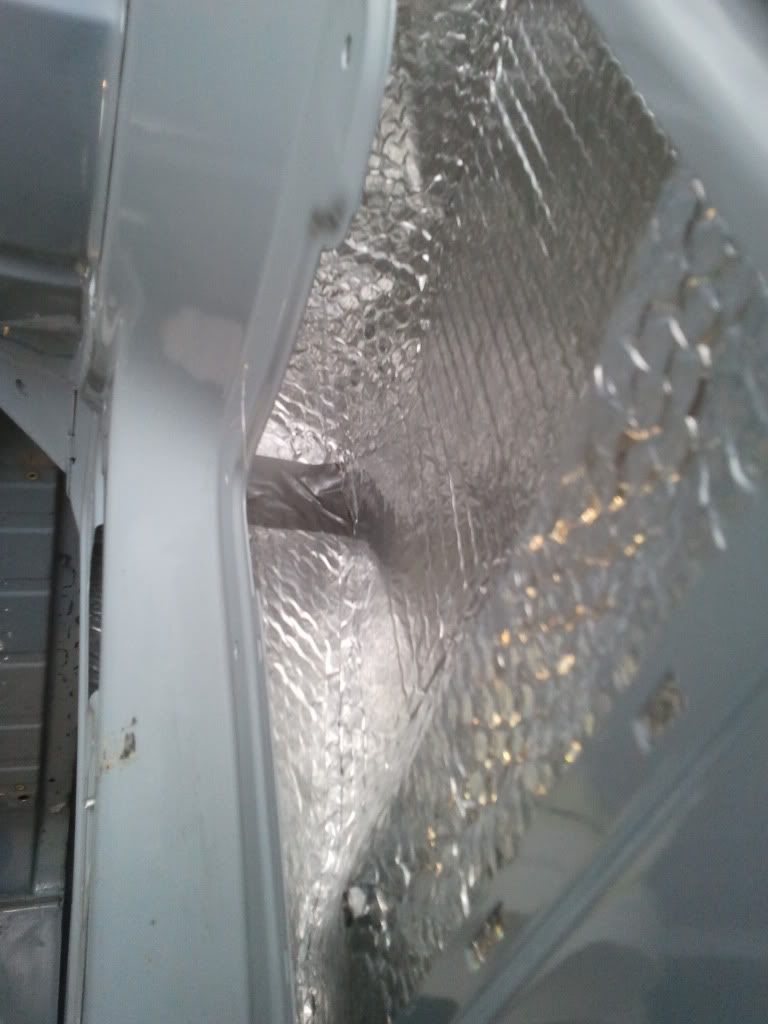

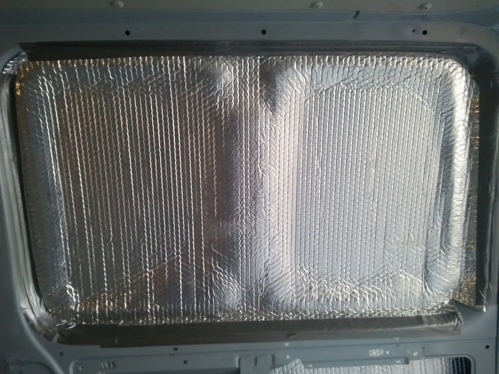

first things first lined the outside with Airtec Double Insulation foil, i used heat resistant spray glue from a well known company on the forum (not sure if i can mention names or not) but they know who they are. service was superb A:
i made sure every nook and cranny was covered and sealed to ensure no loss of heat. some may say it's a little bit over kill but better safe than sorry later.

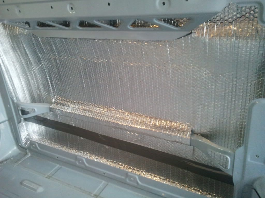

so all the outer layer is done time for some insulation,
for this i used space blankets Wickes had a special offer buy 1 get 3 free
didn't like the idea of all that foil sitting to close to the electrics and heating up so i left a little gap between the insulation and the lights
for the top panels i split the blankets took some layers of and re sealed the bag wasn't 100% sure if they would fit once they expanded
then once that's was done i covered the lot with another layer of Airtec Double Insulation foil to seal it all in

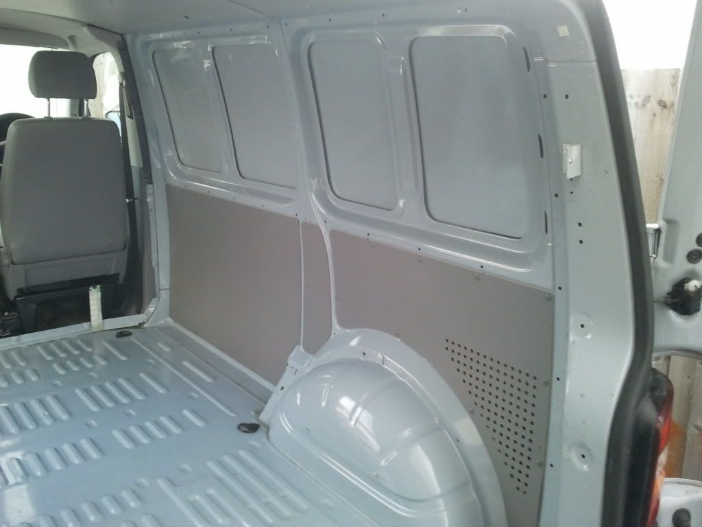

ok so bit of a busy weekend in regards to working on the van. flashband on the arches and started to carpet the metal work
wheel arch done, overall really happy with the result superb material to work with and very forgiving thankfully
made a start on the metal work by covering any holes with aluminium tape bit time consuming but better safe than sorry

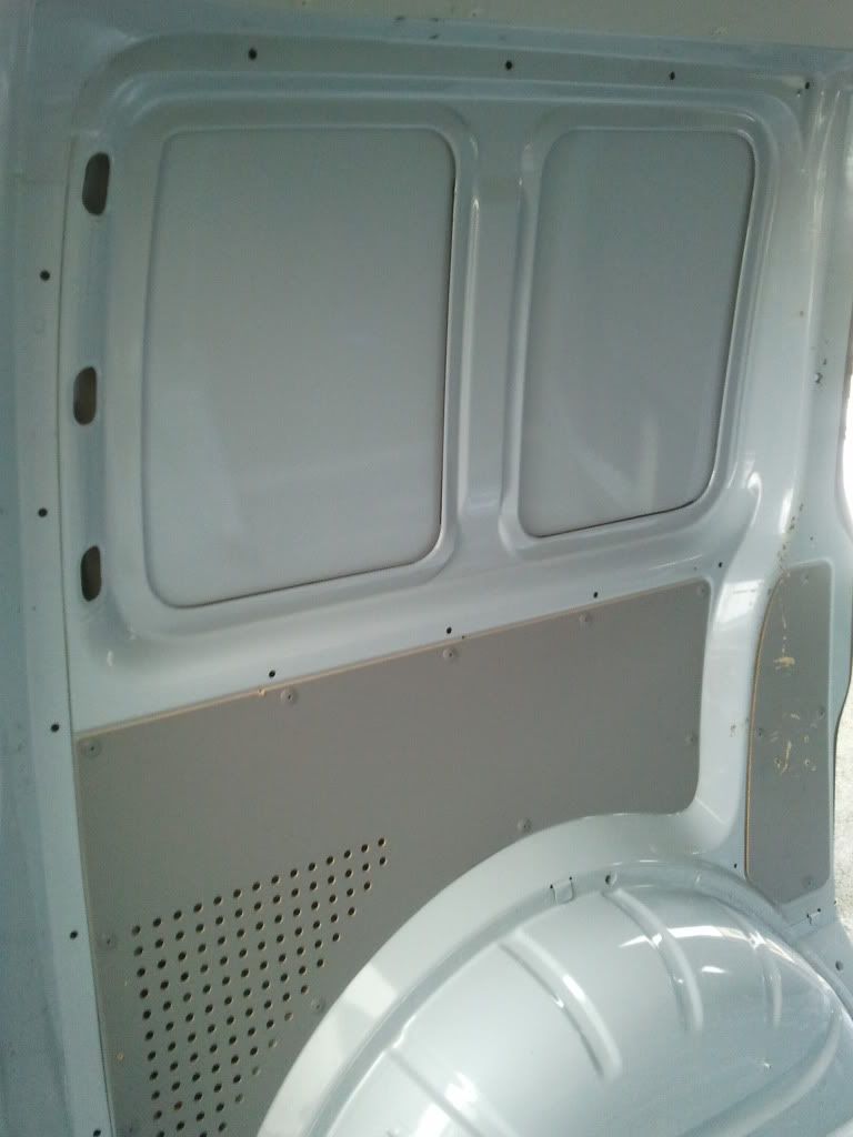

so majority of interior metal work carpeted, im wanting to keep the panels separate for now for easy access behind should i need to.
next step panels carpeted and ready for fitting, it was a bit taxing cutting out window but hopefully worth it in the end
you have to forgive the quality of the pictures taken on the mobile whilst on the move
still not 100% sure about the window cut out but time will tell easy enough to just take it out should it require

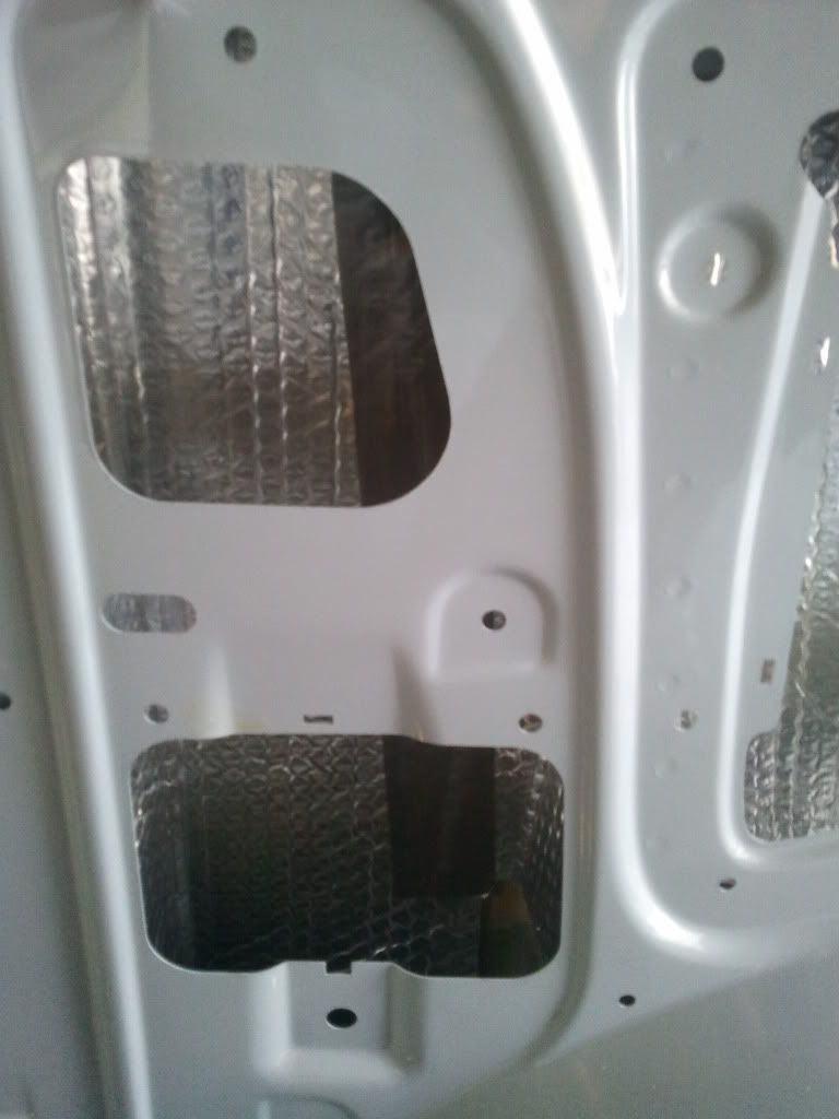

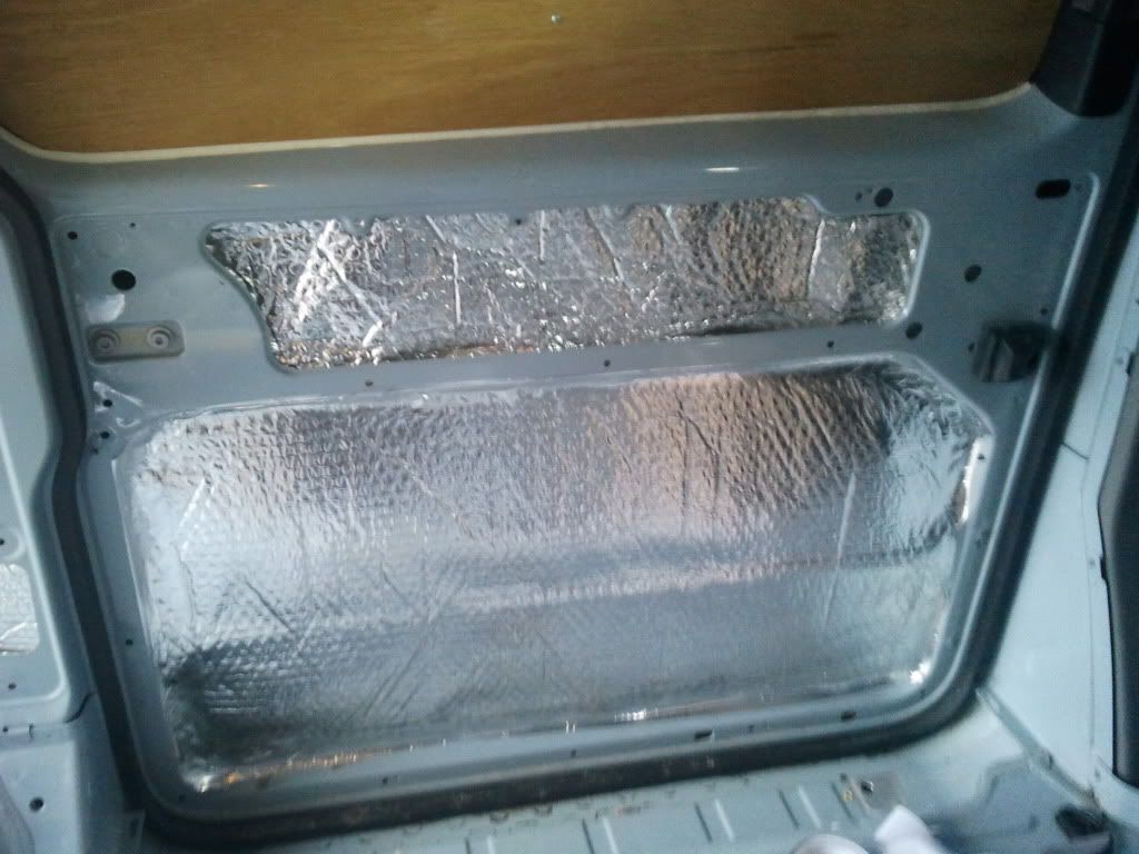

started on the rear doors, lined the exterior with thermal wrap then a layer of space blanket and then another layer of thermal wrap i had to split the blanket and re seal it to fit into the top panel :D
once both doors had been insulated i did what some may see as a mortal sin :eek:
(carpeted the ers) i know its frowned upon due to seal issues but i made sure i cut it just shy of the seal
they open and close just fine so far and we've had some proper pooh weather up north since and all is well T:
mind it was a bugger getting the interior handle to fit back in place. nothing a hammer couldn't solve A:
still needs a bit of a clean and trim in places but just purely for cosmetic reasons

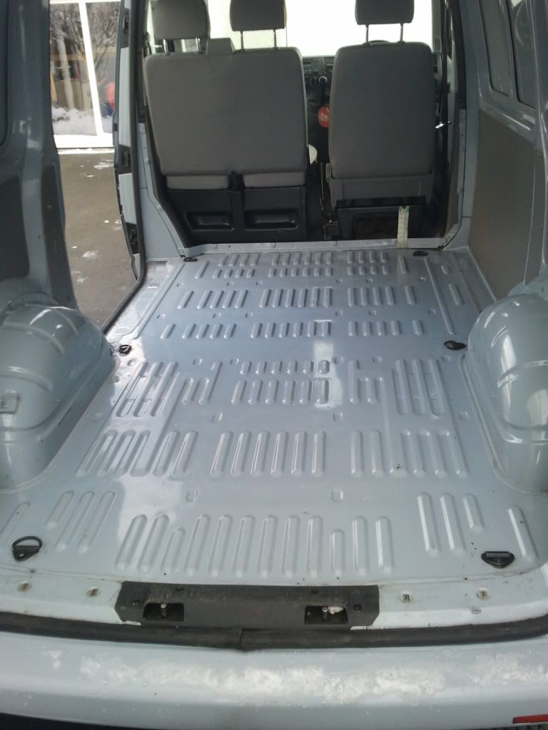

so ive seen so many people go on about batons etc. i thought id make use of my solid wood flooring left overs and funny enough they where the perfect thickness to match the ridges in the original floor T:
i left a gap between the right hand arch and the baton because im wanting to introduce a 240 hook up at some point and i see alot of people have put it under the rear bumper and then ill run the wire under the floor to the front of the van.
im not going with the usual full side wall kitchen units route im going to put a unit across the back of the front seats im sure there will be a smev going in somewhere but as yet not 100% decided where
my intention is to insulate between the batons at some point but for the moment ive used the thermal camping roll mats that are available from a well known outdoors store I: (cheap too) my intention is to glue the mats straight onto the ply floor before i put it in but as you can see from the picture this doesn't really need to be done. ;)

2,478 Posts
Hi looking good mate T:
Did you use 12mm ply in the end?:
I thought 12mm is what i needed but just ripped up my floor and it looks like 8-9mm in battons....i dont think 12mm will go under the plastic door steps , mines allready got the deeper ones as its a shuttle.
Steve
5,746 Posts
Steve
9mm packers between the ribs and a 12mm ply floor plus 2-3 mm vinyl work outs perfectly.
