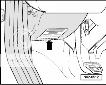

Vehicle data sticker
The vehicle data sticker -arrow- is mounted on the dash panel trim in the footwell on driver side. The data sticker is also found in the service schedule for the customer.
On the left side of left-hand drive vehicles, on the right side of right-hand drive vehicles.
The sticker contains the following vehicle data:
1 - Production control number
2 - Vehicle identification number
3 - Model identification number
4 - Model explanation/engine output
5 - Engine and gearbox code letters
6 - Paint number/interior equipment identification number
7 - Optional equipment identification number
2,829 Posts
