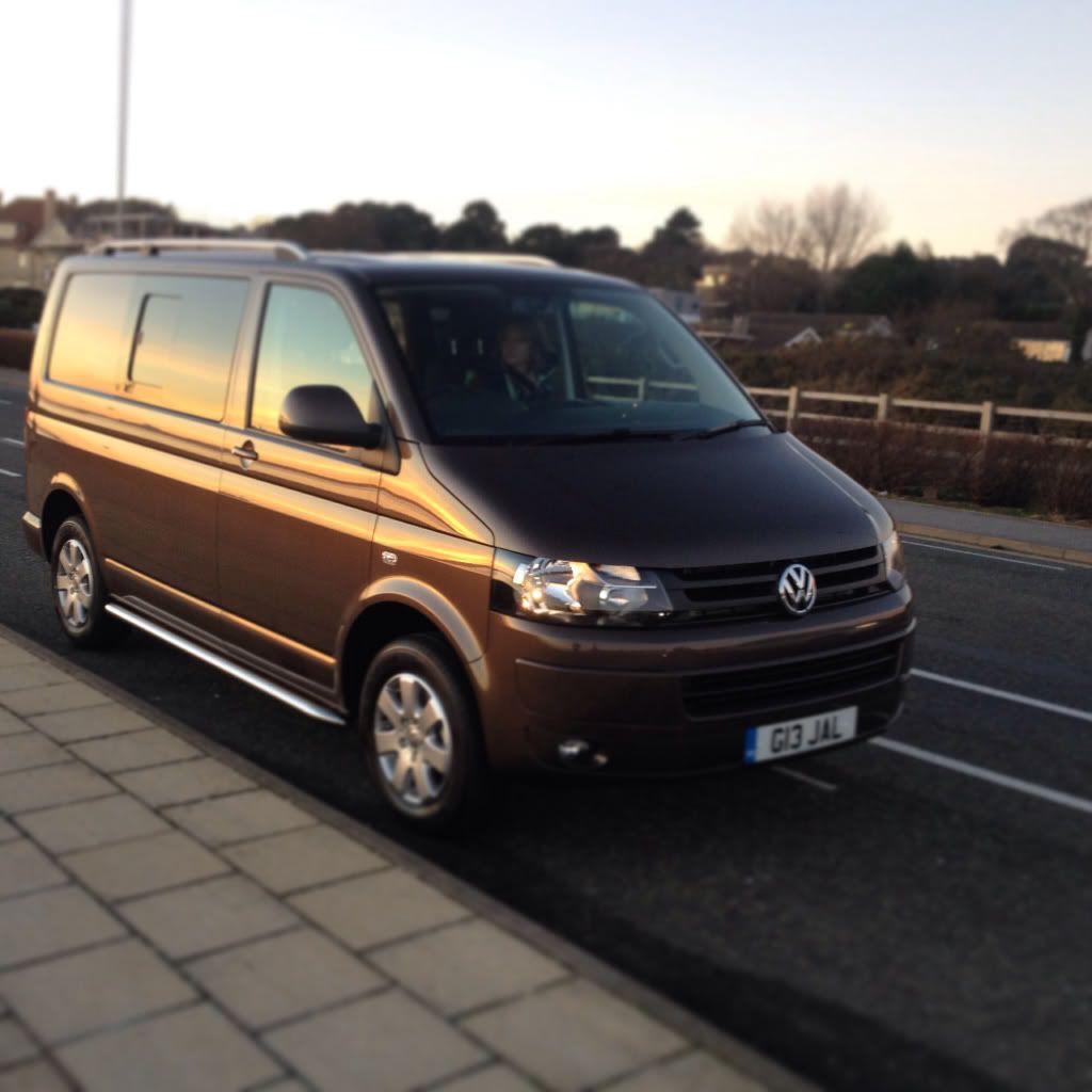

Well like a lot of people out there I'm embarking on my first journey into van conversions, starting with my new T5.1 panel van
Highline spec.
Waiting at vw dealer
First Up a bit of outside bling so roof bars and side bars to stop door dents!
Next job sound deadening :)

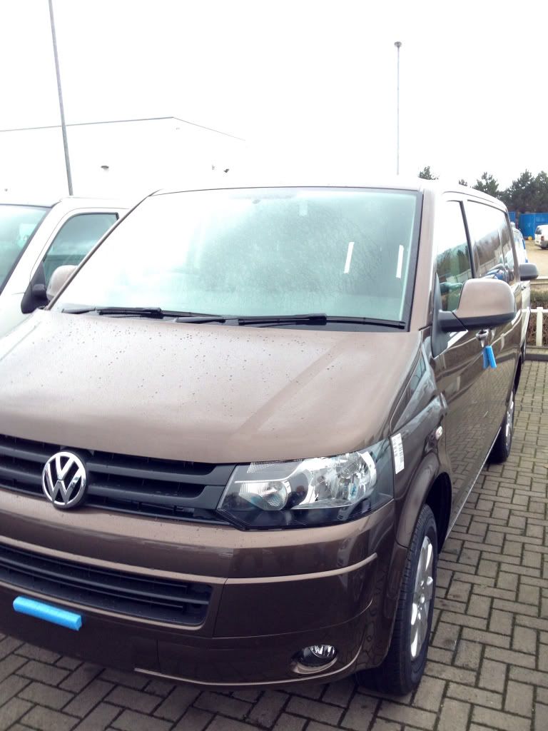

Highline spec.
