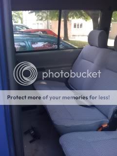

Cleaned the seats:
From:
To:
Washing powder, warm water, nail brush, elbow grease and VAX (but ours is a Hoover).

Some more cleaning of the seats...after all, it is an 8 seater:
Before
After
