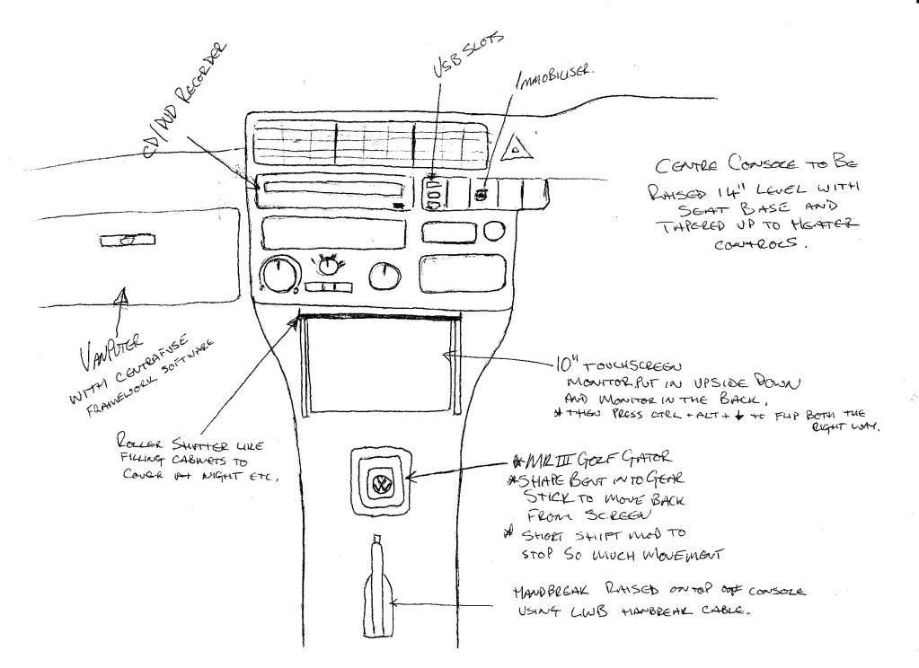

Thought I'd start this thread off as I'm picking up an 8" touchscreen monitor tomorrow for £50.....Bargain :D
Basically this is what i'm building. (excuse the poor artistic skills I:)
Going to build a custom centre consol with fibreglass resin and either
Spray the same colour as the van
OR
Spray the same colour of the dash
Will update as i go T:
