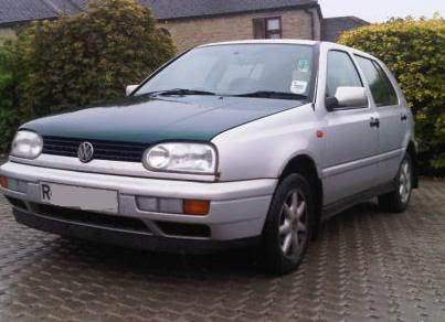

There's no going back now because I've already bought the donor car:

I've got a big stack of new parts to go on the engine before it goes in the T4, including, cambelt kit, water pump, oil pump, new oil and filter, fuel filter, LuK Golf TDi clutch kit, new flywheel bolts and a slack hand full of gaskets and seals.
The golf is going to be stripped of it's engine, gearbox and wiring loom on Saturday........T:
I've already removed the golf dash board, so all the elastic-trickery is exposed and ready to be removed:

Right ho, engine and gearbox removed from the golf yesterday (i'll get some pics up later) and off to whip out the loom today, to whit, do you need to remove the servo from the golf to get the loom out? It looks very tight! Would it be best to pull the loom into the engine bay or into the cab?
Pete
1,822 Posts
do you need to remove the servo from the golf to get the loom out? It loot very tight! Would it be best to pull the loom into the engine bay or into the cab?
Pete
Yes remove servo (three/four 13mm nuts in the drivers footwell), pull the harness through from the engine side of the firewall be careful to pass the connector through the opening one at a time.
