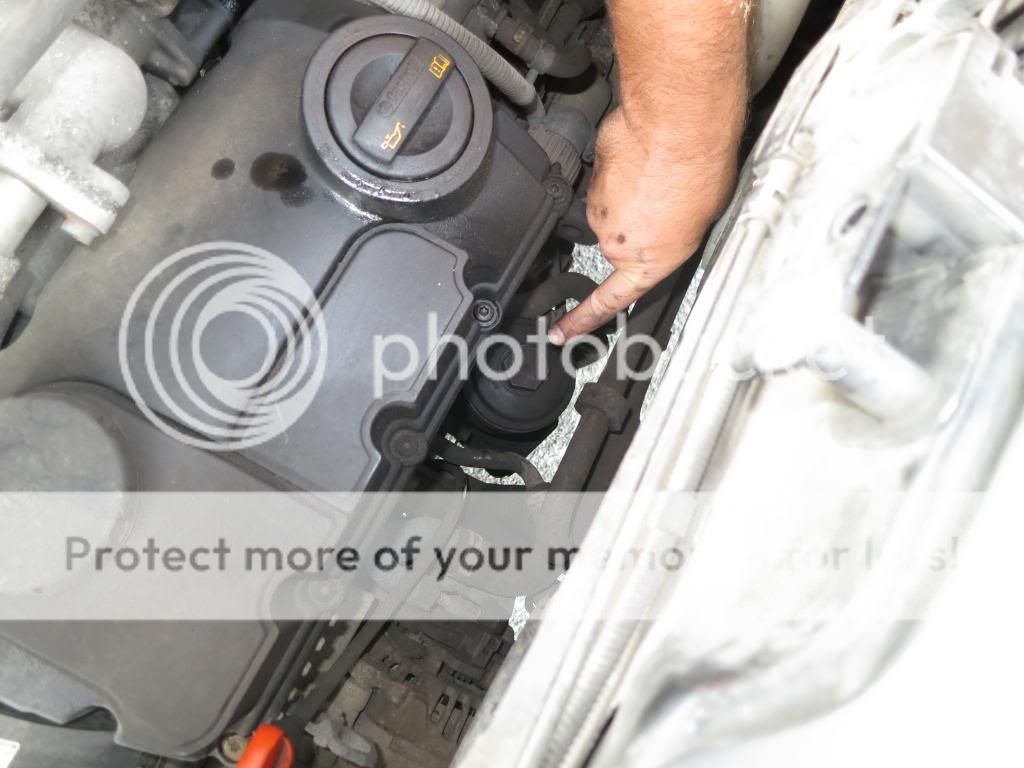

Having never done this before it took me a while to find where the filter was housed but a few searches of the forum revealed it was a plastic top with a large nut, this narrowed it down and eventually I found it. The nut on top is infact 32mm.

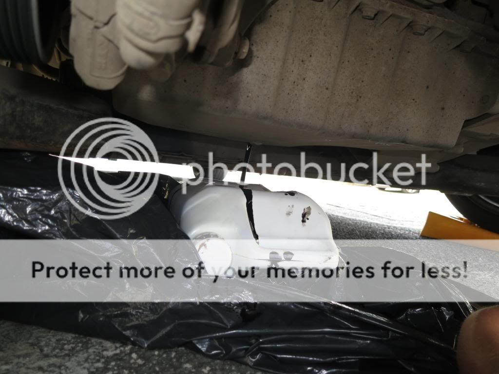

Once I had located everything I drained the oil, I left the oil cap on and just removed the sump plug (located towards the rear of the sump, it is quite easy to find). When the flow of oil slowed I opened the oil cap and let the rest drain out. The oil is likely to flow towards the rear so make sure your bucket is slightly further back than just below the hole. The oil shouldn't be hot, just warm so it shouldn't burn you.
I left this for a few minutes to train totally before putting a few cups of fresh oil through just to flush it through a little bit - just something my dad said to do :)
The oil filter is housed within a plastic casing with the top being removed when you unscrew that nut - an extension bar for the socket and wrench will be useful here.

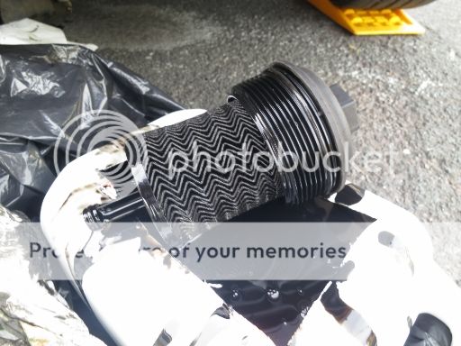

Once this is removed it should look like this:
The filter just pulls away from the plastic top. Included in the new filter is a new O-ring for the plastic top, don't forget to replace this.
The new one just clips on in its place:
