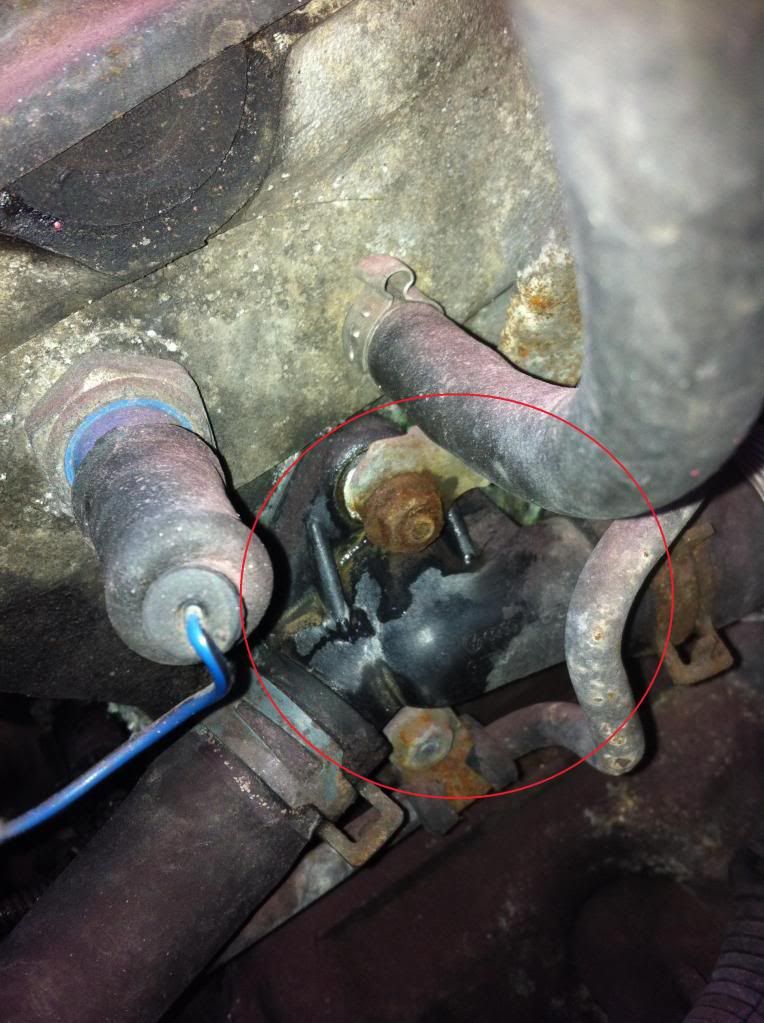

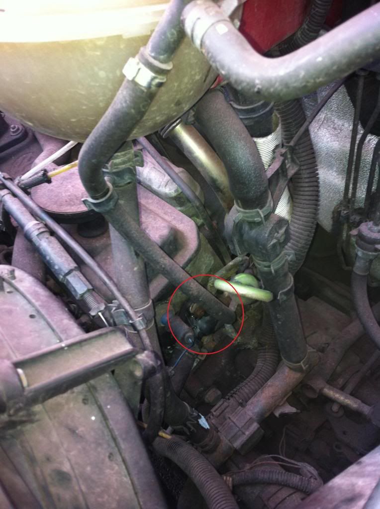

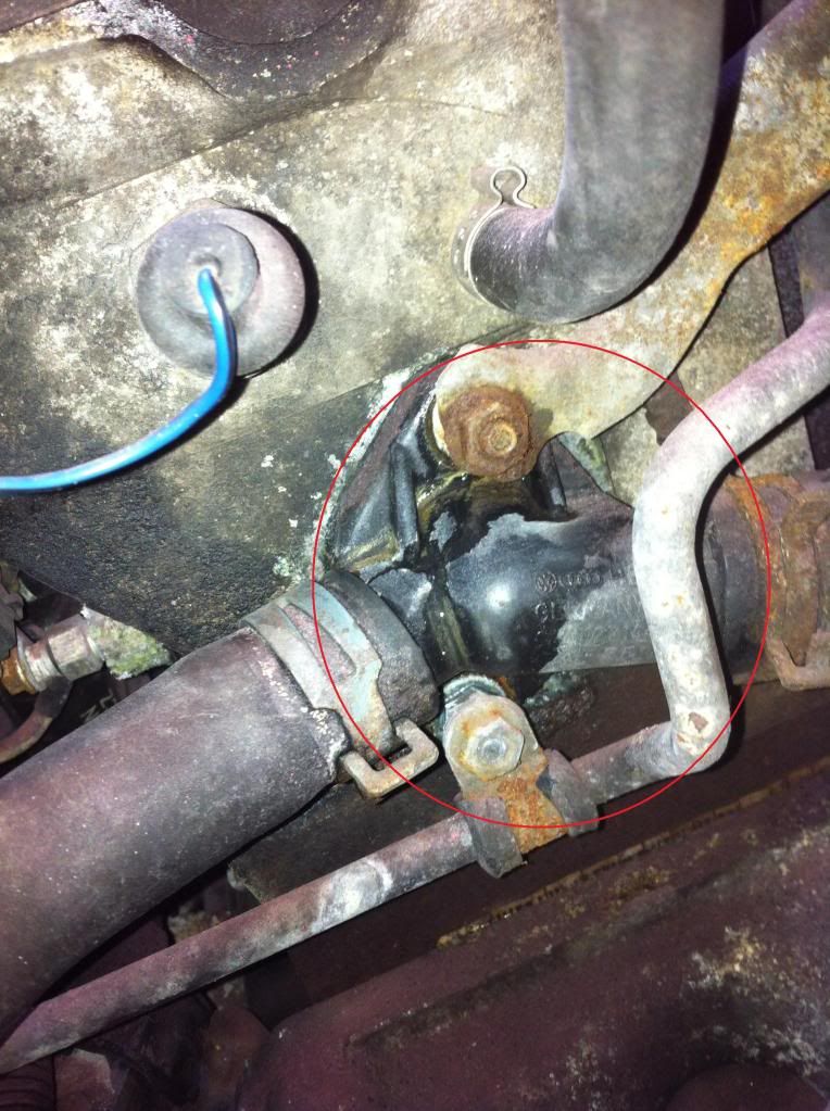

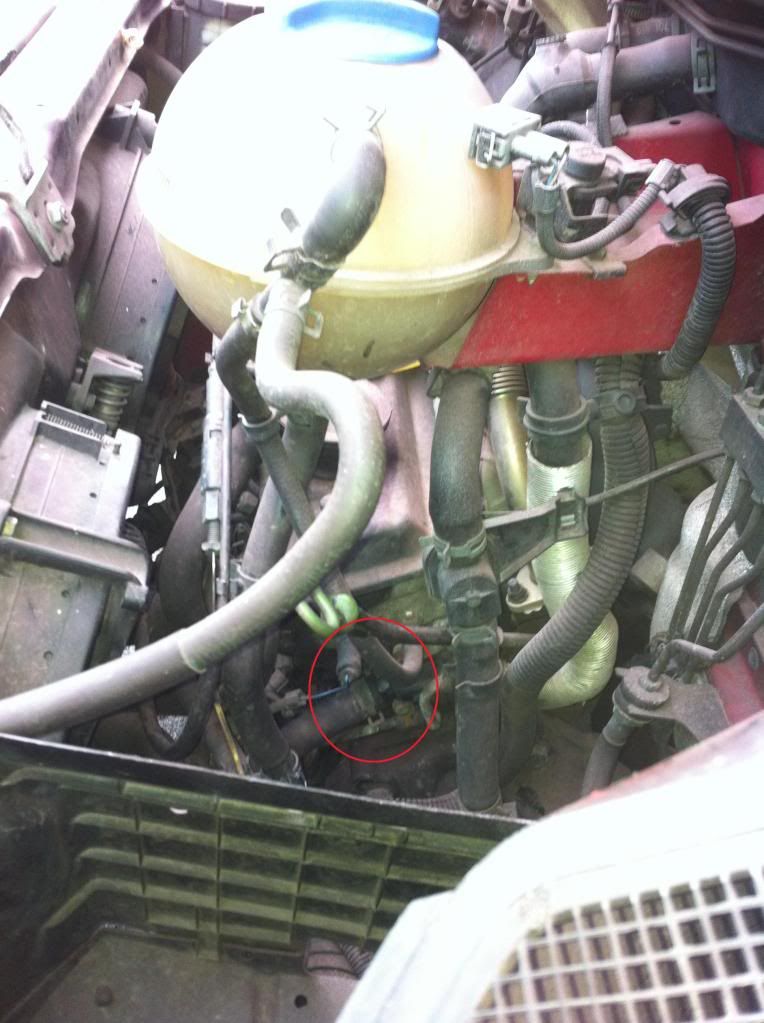

Apologies if this has already been answered somewhere, but I've got a coolant leak which appears to be coming from a plastic connector on the right hand side of the engine if looking front on, just below where the dipstick supporting bracket bolts to the engine. A bit tricky to explain but here's some pics:
Its losing about 1 litre every couple of weeks at the moment.
Any advise is much appreciated, cheers T:
