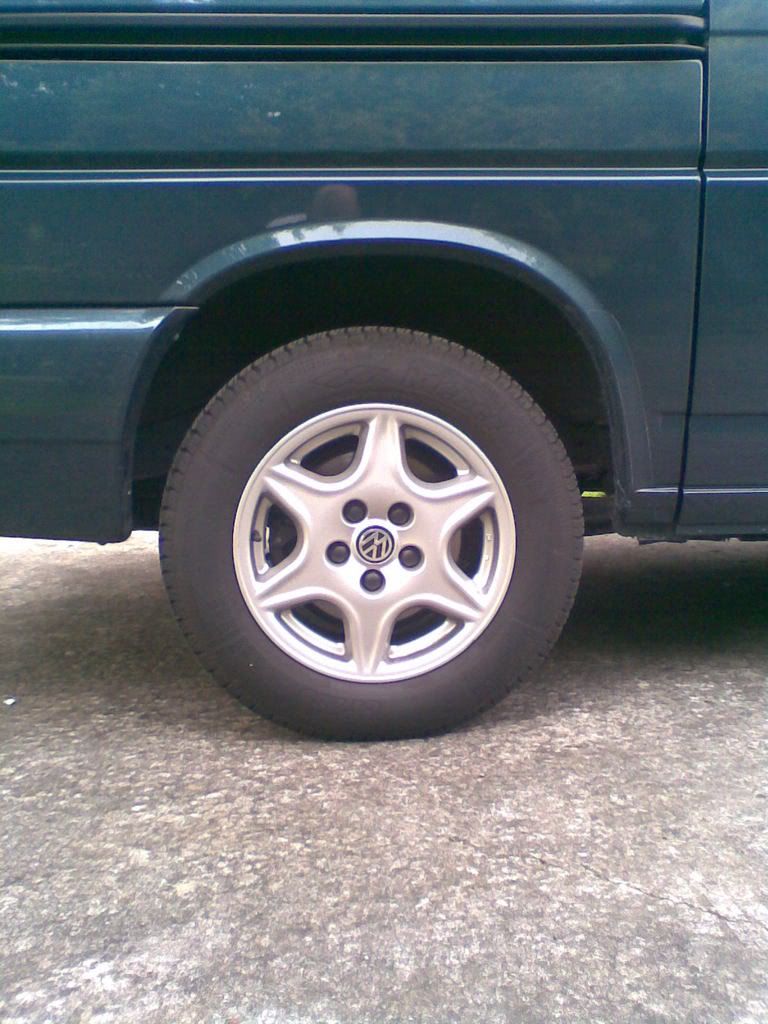

How it looked in May 06
Dropped it on a set of KW's
It did fall honestly, Drop once settled :)
Before
After

O.K finally got around to fitting the wheels... A little too much drop .. hmmm :) possibly
It has changed the look completely very happy with it !
