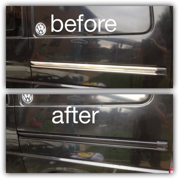

Got my Black Side Rail fitted - thanks to Si "Colese" @SC VW Customs
