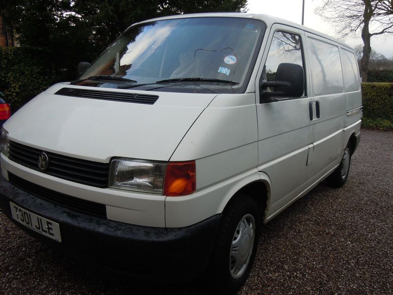

Ha ha, so finally after spending loads of money on our T4 and converting it into a camper from rags to slightly nicer rags,:D

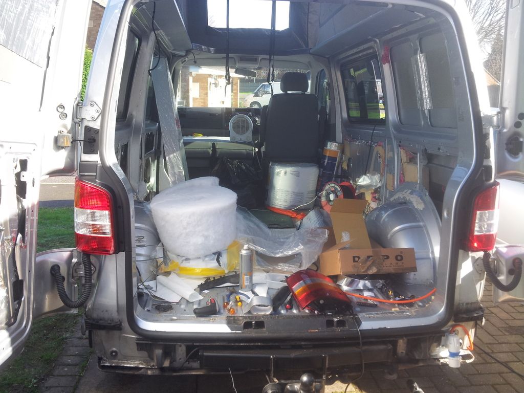

So before Dean got into cutting the windows out we had to remove the previous owners interior. I'm not really sure if its a marmite thing or just too Austin Powers for us :eek: so its going!
And once the units were out then comes the expanding foam stuck down celotex. it surprises me how badly this job has been done even though the correct materials were used!
This stuff was a real sod to get off the window frames so that we can carpet properly!
Part way through the fitting.
Thanks for looking, we'll get to something interesting soon!

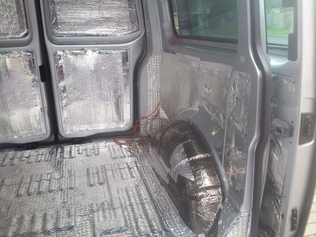

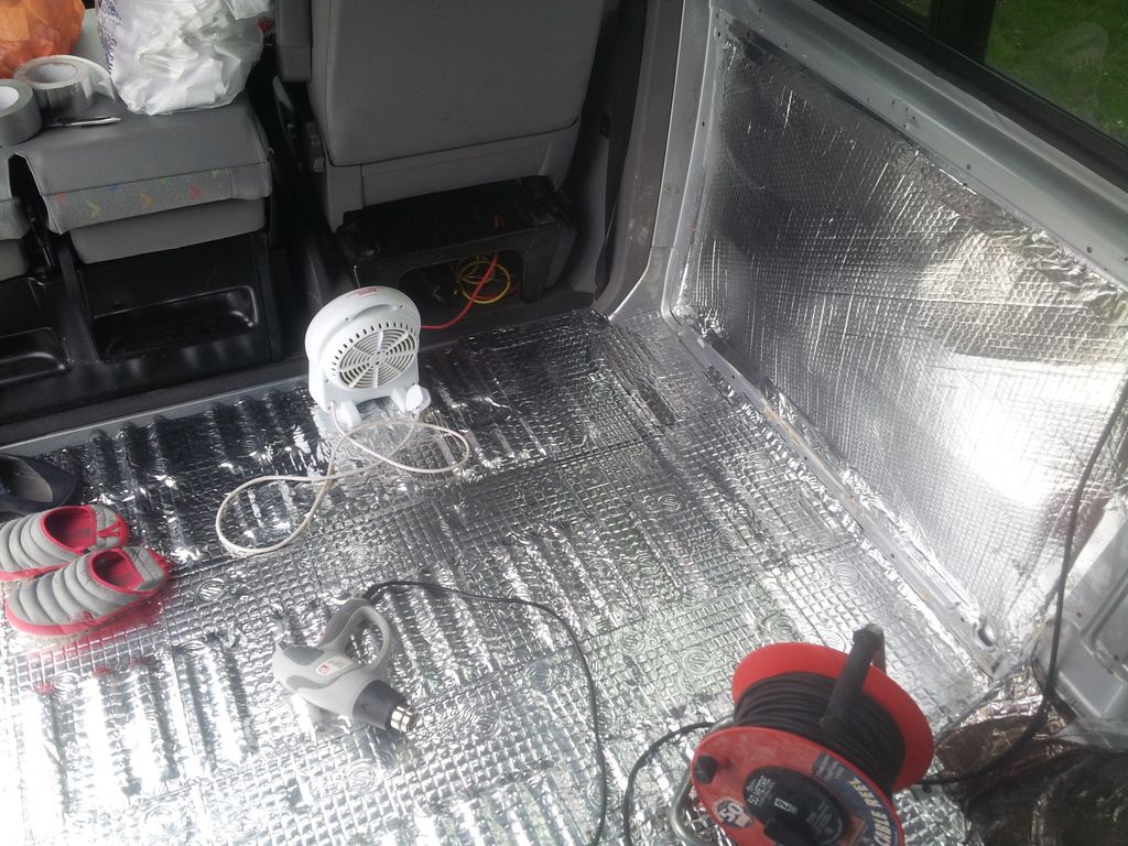

used plenty of thermal wrap, making sure to seal all of the holes/draughts.
cant believe the difference it made to the overall sound of the van.

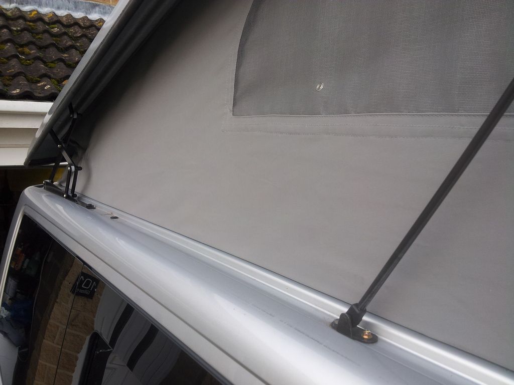

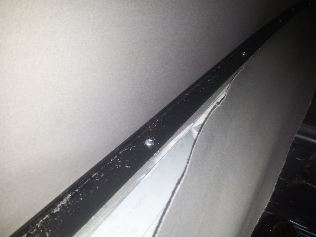

lots of fixing of the canvas down, easy enough. took some time to fit the reinforcing panels along the sides of the van but instructions and help from vanhaus was really good!

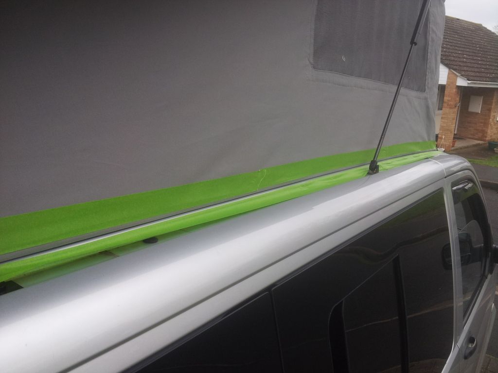

once we finished fixing the canvas down we read of some awful conversion thread of someone who paid a horrific company to convert and they bodged the sealing, so, on the advice of another member here we masked carefully the edges and then sealed carefully trying to avoid too much sealant.

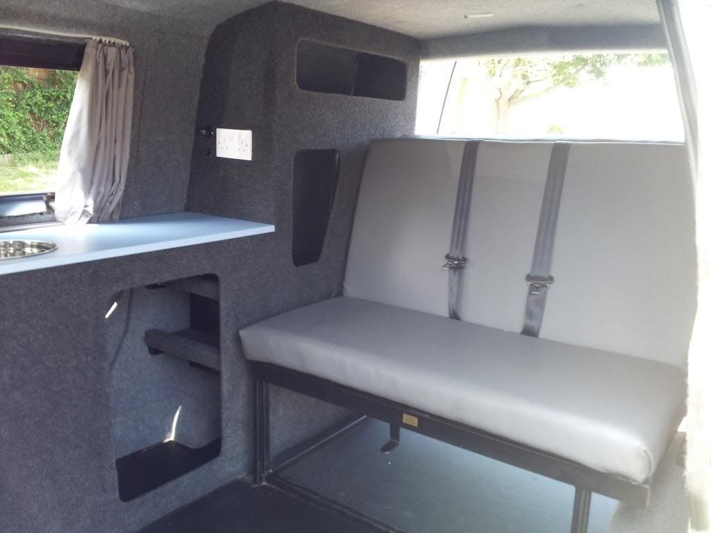

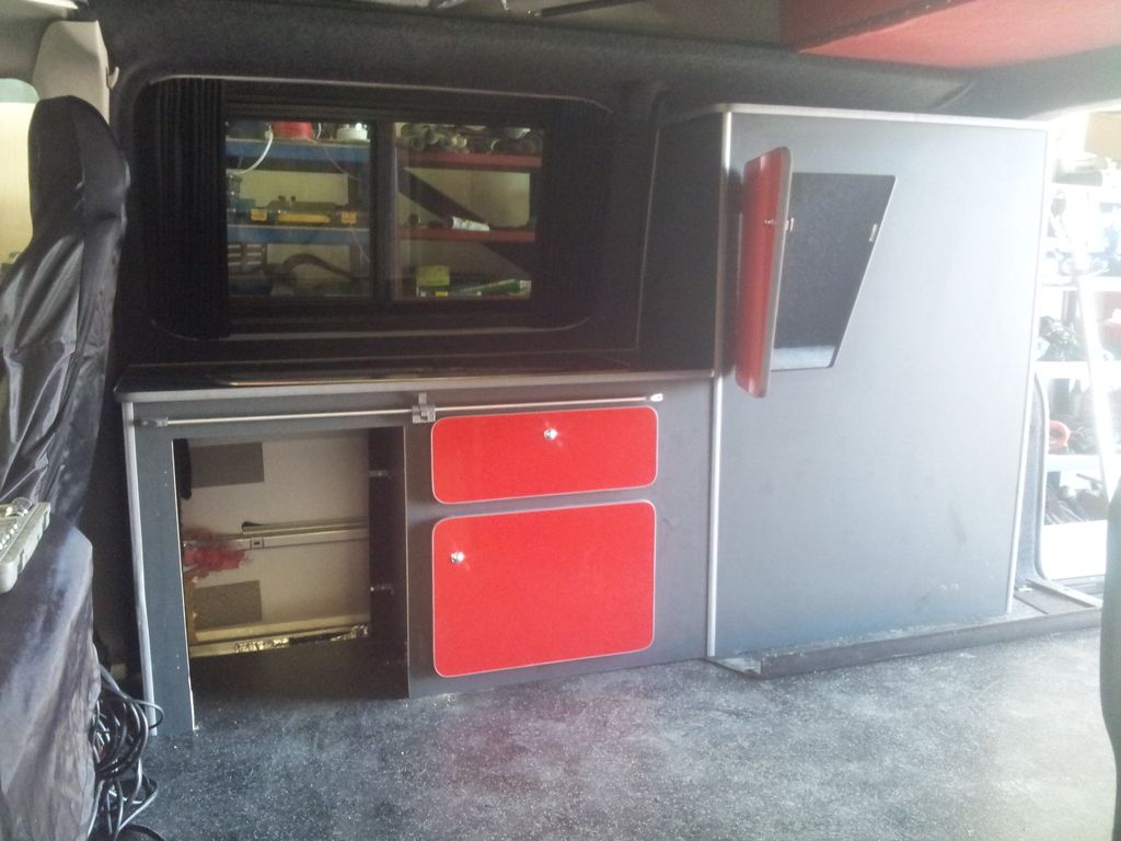

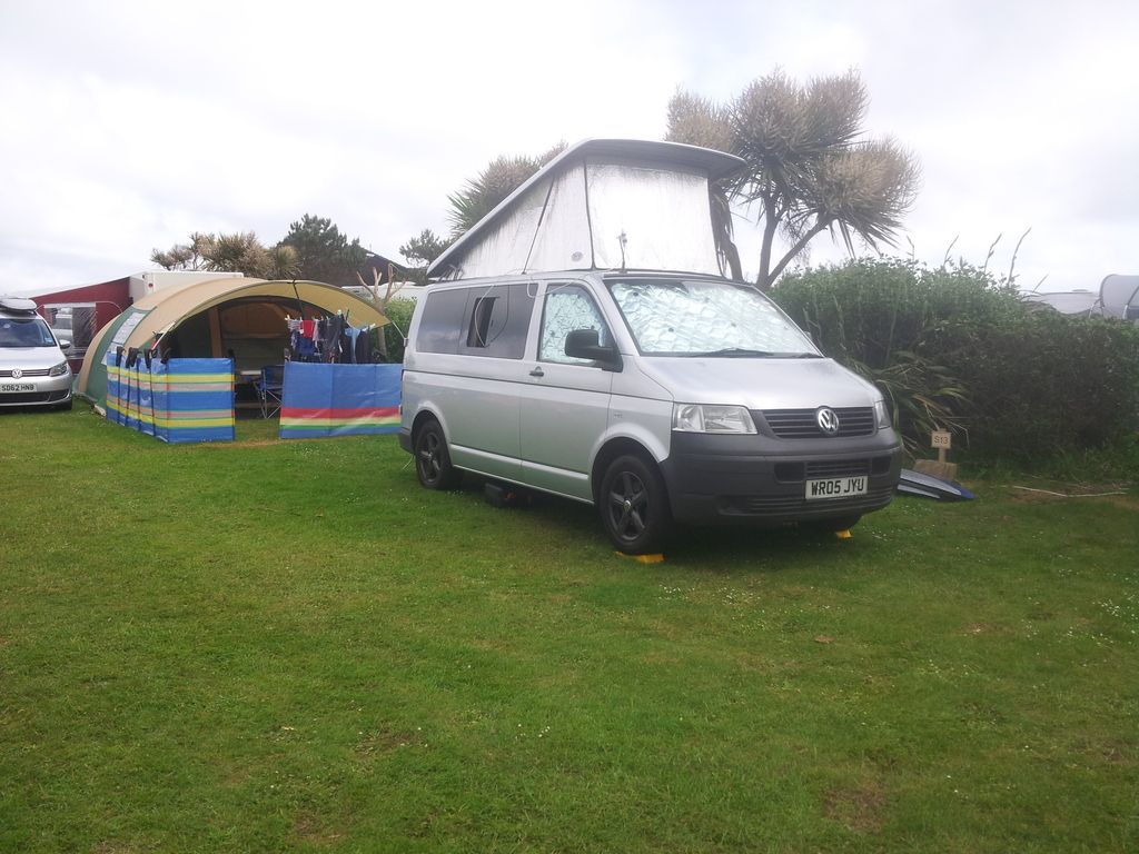

then we went to mvm campers up in the valleys who did a really good and economical job of the "vohringer" units. helped the guys fit and pleased with the results
then it was hooking up the gas and fridge, all worked well but bloody expensive fridge!!
then time for the shows and camping!!

Cheers mate, its Silentcoat 2mm sound deadening bulk pack 40 sheets probably need 2 packs if doing floor ÂŁ80 each pack!
silent coat isolator 6 sound proofing and then insulation (B&Q recycled plastic fibre, all sealed in with the B&Q thermal bubble wrap and plenty of aluminium tape)
thats what most people do. I think if you ride it on long trips the sound deadening and proofing are worth it.
