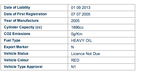

Interested if someone could answer this for me as I've just put a deposit down on a 2005 1.9 85hp. Its currently a professional wheelchair carrying conversion by Versa and as its on motability its £0 road tax. When I buy it, it wont be on motability, so what will it be?
Its also listed as N1, so if I was to show the DVLA photos of the conversion, could it be converted to M1? Is type approval fairly straight forward or are there costs involved?
