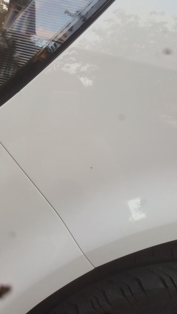

I know its tiny. But thats rust right there.
Sorry op not filling you with confidence in Vdubs. Just goes to show everything rusts especially 20 year old things.
