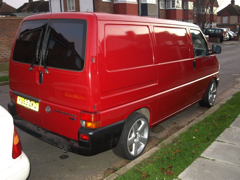

I thought it was time I started my build thread with my new bus.
I've had it for around 3 months now and done quite a bit here and there.
I am doing a full camper conversion with it and hope to get it finished within the next 2 months.
I was looking at buying some vohringer boards and doing the lot myself but after mucho measuring, drawing and thinking I decided that I havn't got the right tools and know how to take on such a job so i've opted for the Ikea route instead.

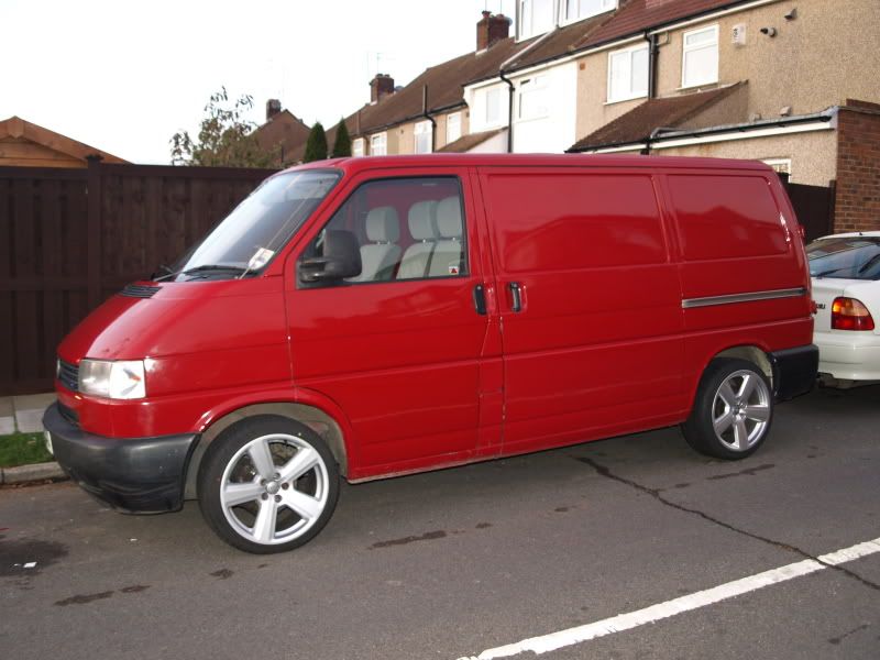

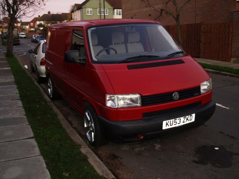

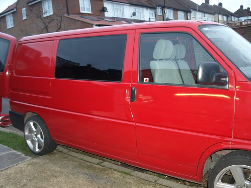

Anyway here goes... This is pretty much how I got it apart from the wheels which went on straight away and some -60mm lowering springs.....
It's a 53 plate swb which I got for the lovely price of ÂŁ2100...
Not a bad starting motor and it's in really good nick and runs like a dream.

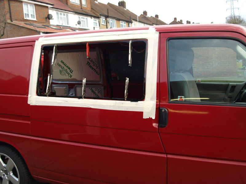

Next job was some side windows from VW and then tinted and fitted by myself...

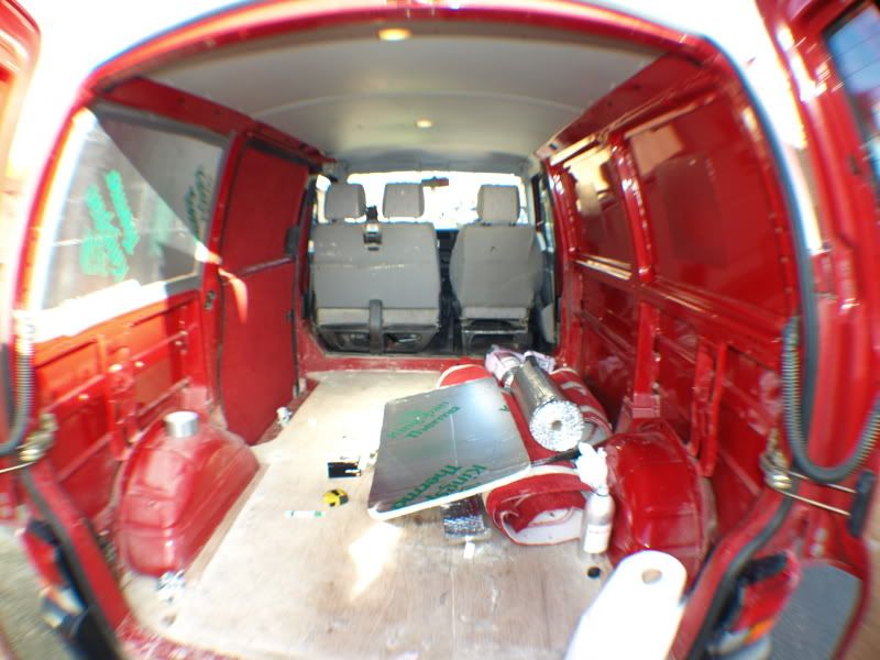

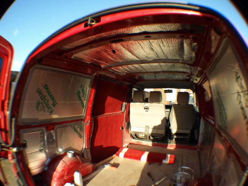

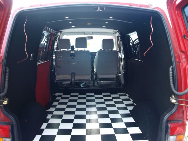

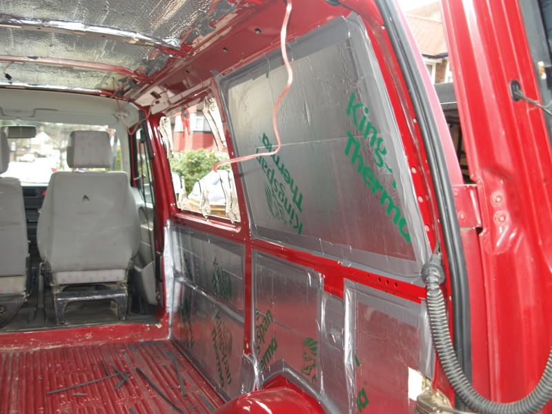

After fitting the windows the whole interior ply panels, floor and carpet were stripped out of the back, Completely cleaned up and then the dreaded insulating could be done....
Got my self down to b&q and picked up some kingspan and a couple of rolls of silver thermal insulating roll that was buy 1 get 1 free T:
Once all that was done I got all the original ply panels carpeted and some nice flooring and got it all fitted up and fixed in position with all the required wiring hidden behind for later...

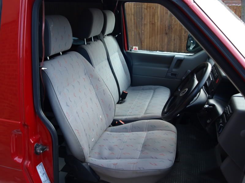

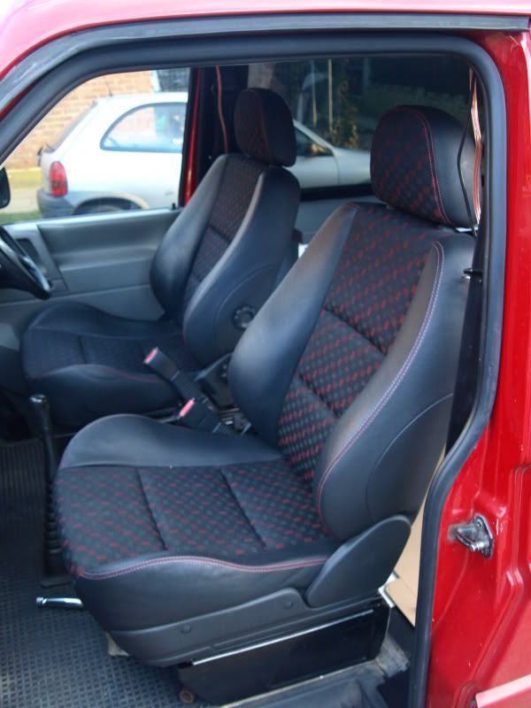

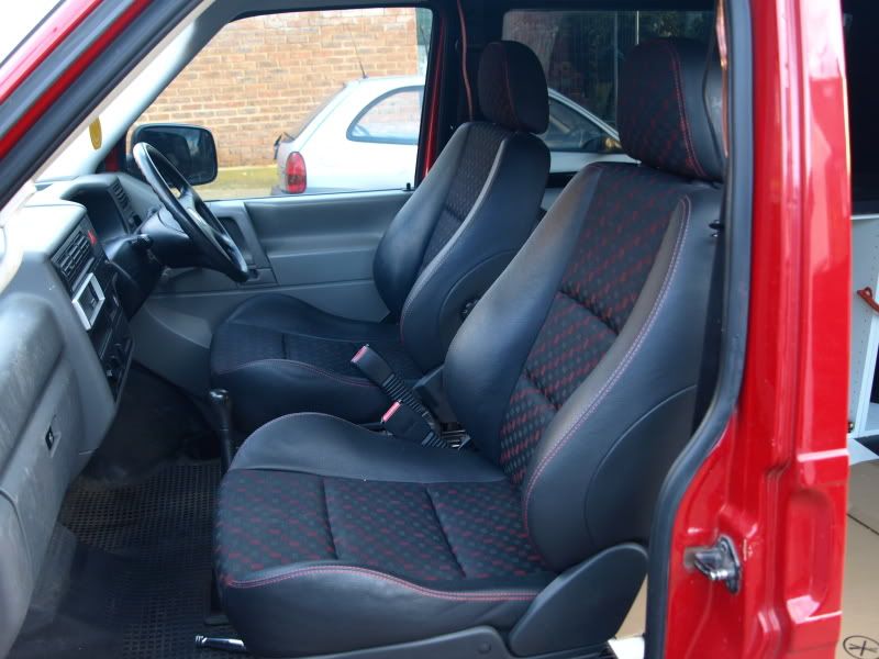

Next in line was a new pair of seats as I wanted 2 singles that were a bit more racier.
So the olds ones were out.
And I won a full interior for an MG ZR off Ebay for ÂŁ46. And another single seat base.
So after collecting these went in with not much problem at all and they are really comfortable and I think they look the nuts aswell...

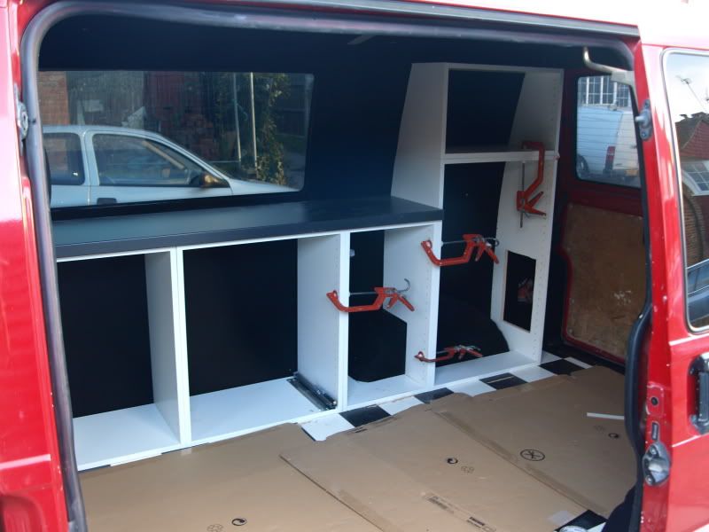

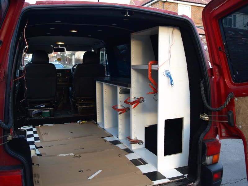

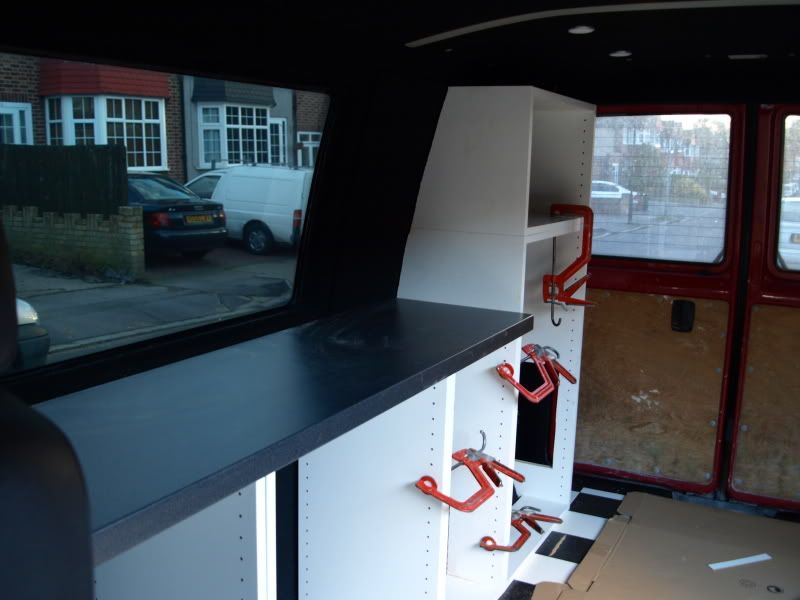

Ok, so next job now is making a start on the interior. Went down to Ikea the other day to get everything I needed to get started, apart from the doors because they have to be ordered so they are on the way soon.
Got it all home after paying ÂŁ190 including doors and hinges and got it all made up..
Next I set about chopping it all up with a jigsaw to make it fit the van.
It's all starting to take place now.
Next steps are get a sink and hob in the units and finish the electrics before I secure it all in place and fit the doors.

All the units are gonna be fixed in plase with L-shaped brackets and self tappers that I got from b&q and also scew through the floor with them aswell.
The sink and hob i'm using are cramer/dometic ones that look just like smev jobbies with the glass lids and they are 410mm/335mm so will fit the worktop just right. Got to get those next month now though when I get paid!

Right then, i've had a few more days off work and been doing a bit more on the van inbetween the rain/snow showers!
I've managed to get all the units in to place and bolted down now. The doors eventualy turned up so they have gone on except one because it was damaged so i'm waiting for another to come out.
I got some nice nickle push button catches for the doors and they look really nice with the black.
I've also managed to get the split charge kit installed and up and running with a small fuse box for everything to run off and tucked it in the bottom of the rear panel.
I had a nice delivery thismorning of a Cramer sink and hob with glass lids that I purchased yesterday lunch time for ÂŁ189 including p&p and they turned up less than 24hrs later, so I was well pleased with that.
So, once it stopped raining I got to work cutting some more holes and getting them fitted.
I ran out of light in the end tonight so i've got to put all the doors back on tomorrow and do a few little bits here and there and then thats the units finished.
Then i've got to try and find a rock n roll bed from somewhere but it's really coming on now and starting to take shape.

The seats were pretty easy to fit really. The runners are a little bit wider so I just made up some small metal brackets to fit between the runners and the base. All in they took about 1 1/2 hrs to fit. T:
