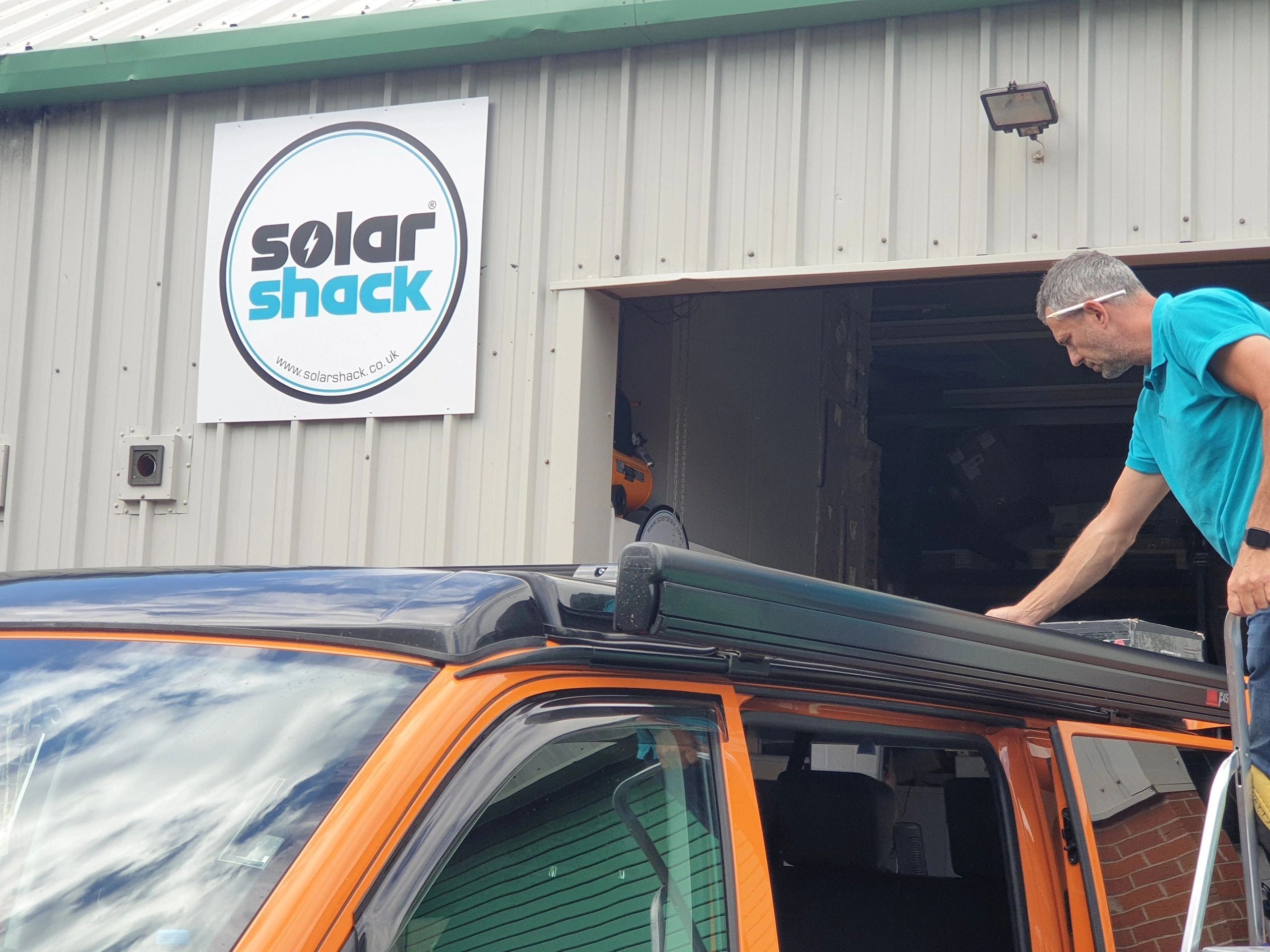

#12 ·
My mate used these folk to fit his 350w panel on his HiLo roof. He was 100% happy and he is really fussy!! Was rigid though. Think he paid around ÂŁ650 all in. Took a few hours.
