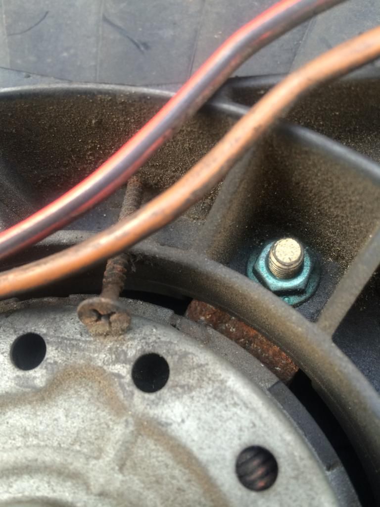

hi mate had this problem, my issue was fans not working, and so aircon compressor getting too hot, thus clicking in and out, and pulling that fault code. open bonnet as you face it on left of rad pull off sensor plug and short out two of the three wires in different ways, you should be getting fans come on, if you have no fans, you have the problem, which in my case was replacing the fans. you may not notice this as even if the fans don't work you are very unlikely to have an overheating van.

#18 ·
Dude, its the rads, they both dead i'd say, perhaps one died before the other but they dead, if you have a probe put that on and power the fans individually direct, but im sure you wont see any movement, my fans were dead, one died before I bought the van because it never worked, the other was hanging on.
I got two new fans for a little more that you found for one, veedubmachine is who you need to call, I ordered mine delivered next day!
